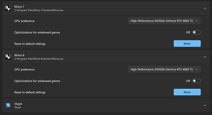

You can force the ā€œHigh Performanceā€ GPU at the windows level by creating an application profile from within the Display Settings dialog …
With Rhino CLOSED Right click on your desktop and choose display settings-
Scroll to the very bottom of that page, you should see an option for ā€œGraphics settingsā€ … click it
A new page appears.
Make sure ā€œClassic appā€ is selected…then click ā€œBrowseā€ button and locate Rhino 6’s .exe file.
It should be located here-
C:\Program Files\Rhino 6\System
Once it’s located, Select it…and you’ll see an Options button appear…
Click Options and select ā€œHigh Performanceā€
Close the dialog and start Rhino… theoretically and hopefully, the NVidia GPU will now be listed as the Primary OpenGL device and Rhino will use the High powered card at all times.

Since this article was created there are new options when choosing graphics specifications for specific apps. You can specify high performance, but there is also an option to toggle called ā€œOptimizations for windowed gamesā€ @theoutside what is your advice for this option?
It is my understanding that you should leave that setting off for Rhino -
