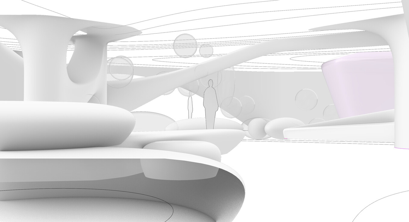

View capture to file creates clipping plane that isn't there
if you set the scale to 1 and use viewport resolution does it help?
Yes it works fine then. But I need to be able to do it at higher resolutions.
ok, if you set it to viewport resolution and scale to 2 does it still clip?
if so, set it back to one and enter the resolution in the custom slot-
multiply your screen rez by 2 and enter it manually… does it work?
just noticed you are miles from the origin… if you center it around 0,0,0 does it improve?
I moved it to 0,0,0 and still in both cases at a custom typed in resolution and just at a viewport resolution scale 2 I have the clipping. Each of the images are labeled for the settings I used.
if you show the camera and adjust it a bit to have the camera focal point be farther out of the scene does it help?
It does not - and I just downloaded the rhino 7 eval and tried it there.
anything strange about your set up, 2nd monitor, laptop plugged into a port replicator or display dock, multiple graphics cards, etc?
I’m so intrigued Kyle that it is working for you just fine! Feels like I’m fighting a gremlin here.
I do have a second monitor, no port replicator or display dock. Cards below:
I sent the file to a coworker, they had the same issue as me with it clipping.
I’ve even gone through and purged blocks, purged in general, inserted it at 0,0,0 all in rhino 7.

I unplugged the monitor, restarted, and i’m still getting the same issue. It even happens when I make a new file from scratch with just plain solids and some simple closed polysurface lofts.
Seems to act up quite a bit when I introduce a plane or box as the ground level, and when I get the camera close to objects. Always looks perfectly fine when I do a scale 1 viewport resolution viewcapturetofile though!
I also checked on the video cards - it’s already set to run high performance and I changed the OpenGL rendering GPU to be the quadro card and power management mode to prefer max performance. Still running into the clipping.
I’ve done it in both r6 sr31 and r7 eval with most current. I’m curious if anyone else is having this issue still since there were a few other above.

The good news - I opened rhino 7 eval up halfway through today and it asked me to update the eval. It’s showing this now:
(7.1.20314.23101, 11/9/2020)
Evaluation
And, my file in r7 is NO LONGER doing the clipping. :star_struck:I tried it in r6 - still happening. :face_with_thermometer: So if we do a remote session it seems like the issue is now just happening for me in r6.

Was having the same issue in Rhino 6 V 6.32 taking an interior perspective for an architectural project I am working on. One corner of the building was on the origin point. units were in feet.
Opened it up in Rhino 7 and it worked fine

Hi, I had never had this issue before, and suddenly within the past month, it decided to start giving me issues. On a whim, I decided to make the tolerance .000001 to see what happened and it wasn’t an issue anymore. This could have been a fluke and there might be a more deep-seated issue, but it is worth a shot. Hope this helps!
In my case the clipping was caused bcs of changing ZoomLens value. Reseting to default solved the issue.
