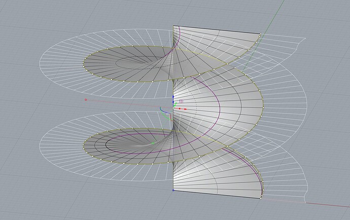

To illustrate this, we draw two things:
(1) For every point on the helix, we draw a line to the central axis. Naturally, this sweeps out an Archimedes screw. These lines are parallel to the world xy-plane.
(2) We ask Rhino3d to draw a curvature-graph of our helix.
For now, please ignore the magenta curve; we’ll get to the tapered helix later.
Archimedes spiral for our helix:
Helix with curvature-graph and Archimedes spiral.
The “hairs” of the curvature graph are curvature-vectors. And we know they should be perpendicular to the helix axis, and if extended would intersect the helix axis. Our helix-axis is along the world Z-axis. Therefore, any side-view of this should show perfectly horizontal lines. And indeed, that is what we get.

Here is our tapered-helix in magenta. For reference, I’ve drawn our straight-helix in black. They start at the same diameter, and have the same number of turns per length. As before, the yellow line is the axis for both helices, and points along the world Z-axis.
So let’s make our “Archimedes Screw” as before. From every point on the tapered-helix, we drop a perpendicular to the central axis. And as expected, this generates a tapered Archimedes Screw.
Finally, let’s draw a curvature-graph of the tapered helix.
Whoa! What happened? As the tapered helix winds more closely to the axis, the curvature increases. That means bigger curvature vectors.
Okay, kewl, more curvature near the axis. What about the direction of the curvature vectors? Let’s look at a side view.
Whoa, those curvature vectors are definitely not perpendicular to the helix axis!
Do the curvature vectors intersect the helix axis? Let’s test one point on the tapered-helix.
Nope. For the tapered helix, the curvature vectors are not perpendicular to the helix axis. Nor do they intersect the helix axis.

Those P/6’s arent’ making sense to me, so I’ll have to reference a different chart.
I agree. It’s been years in the making it would seem. But that kinda adds to the dilemma, cause even GH doesn’t make helix easy, or thread automation easy. And not many accurate / concise youtube vids for Rhino yet either.
And I really don’t agree with this approach:
The only way that can make sense to me is if you’re using ‘helical interpolation’ on a mill in half-turn increments. And I think mills can do full helical, so why half-turn then ‘array’. It’s interesting though.
Yeah, I don’t really see it that way. I’m working on an alternative to show soon, hopefully.
Heh heh. You already told us that you did not do what I did.
You wrote:
That is definitely not what I did.
What I did was I selected both polysurfaces and ran the trim command. Then I clicked on the parts that were sticking out of each polysurf and those parts disappeared. I then ran the join command and saved and posted the result in my reply.
As I said before what you did (trimming with unjoined surfaces) might have worked if your geometry was accurate enough, but since it wasn’t very accurate it didn’t work, but don’t blame me or Rhino for that.
I haven’t waded thru all that you wrote (I probably will when time allows) but my intuition tells me a tapered thread should not behave the same as a straight thread. It has a different purpose. The tapered threads are supposed to jam together while straight threads are not.
Also the spiral that defines a tapered thread is (or should be) consistent throughout so any deviation from the normal frame should also be consistent throughout. Are you seeing something different?
the idea behind not doing a full, but only a half turn:
  • avoid that a suface shares a vertice twice in the final PolySurface (red x dot)
  • make sure that pull (which is part of most trim-Actions) has a easier job.
I remember some older CAD-exercises (not in Rhino) where Cylinders where represented with two 180-degree turns / surfaces.
And pull quite often does a messy job on special surfaces - see this topic:
(which never got much attention)

select the edges not the surface - at least in V7 it works - don t have a runing V5 version on this machine
attached file should be V5
Ah yet again you found another way different than mine that fails. You really do have a lot of time to spare to try different approaches.
This method, also, would likely work if your geometry was more accurate.
what I did using Rhino5:
Hi Steve,
You have to select the grey piece and the red piece before hitting CTRL-T, then select the grey bit you want gone, then the red bit you want gone, then hit return to finish. Think of this as the Mutually Assured Destruction variant of Trim!
Trying to select just one piece and trimming the other, followed by selecting the second to trim the first does not work because the second trim fails. (Although this can be rescued by taking the intersection between the truncated piece and the untrimmed piece and using that to trim the latter.)
When you come to do the other end, know that, in Rhino 5 at least, there will be some positions where even the MAD trim won’t work because Rhino can’t solve the intersection. If you are unlucky enough to hit that problem you will need to nudge the end piece along the axis a little and/or adjust the slope of the shoulder slightly to get a working intersection.
HTH
Jeremy
Since you ask…
The geometry is faulty where the threads join together.
This is what it looks like before the threads are joined:
There is a pretty big gap between threads right where the red cone intersects the black threads
surface_mismatch.3dm (409.9 KB)

I have never done a mirual trim before, was not aware of that method, I always do the standard select trim, select cutter then select item to be trimmed, following its prompts.
thread_end Jim Rhino pick red and grey trim and pick red and grey works.3dm (1.1 MB)
Jim Mutual trim works :star_struck:
A new method for us all.
Now I dont understand why that is and not one at a time, but obviously what one needs for a cut is not there in stage 2 of normal trim.
