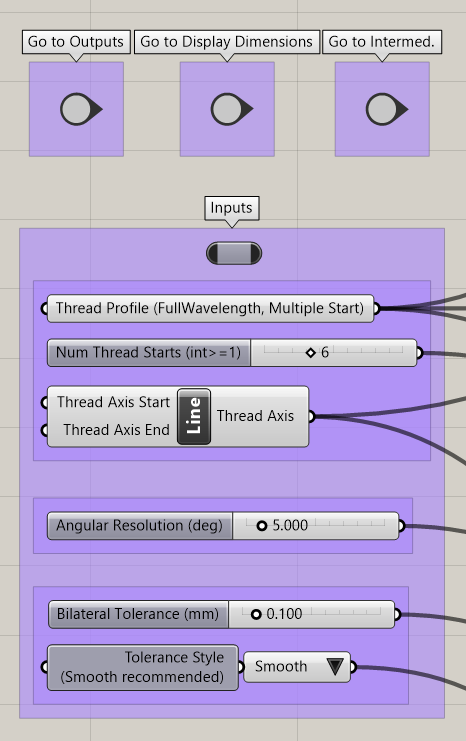

Inputs:
(1) Two points representing the start and end of the thread-axis.
(2) A curve that represents a full-cycle of thread tooth profile.
(3) Number of thread-starts.
(4) An angular resolution. This is the sampling-resolution used to generate the thread-helix.
(5) A thread tolerance. The external-threads (bolt) will be smaller by the thread-tolerance. The internal-threads (nut) will be larger by the thread-tolerance. That means there will be twice the thread tolerance between the internal and external threads.

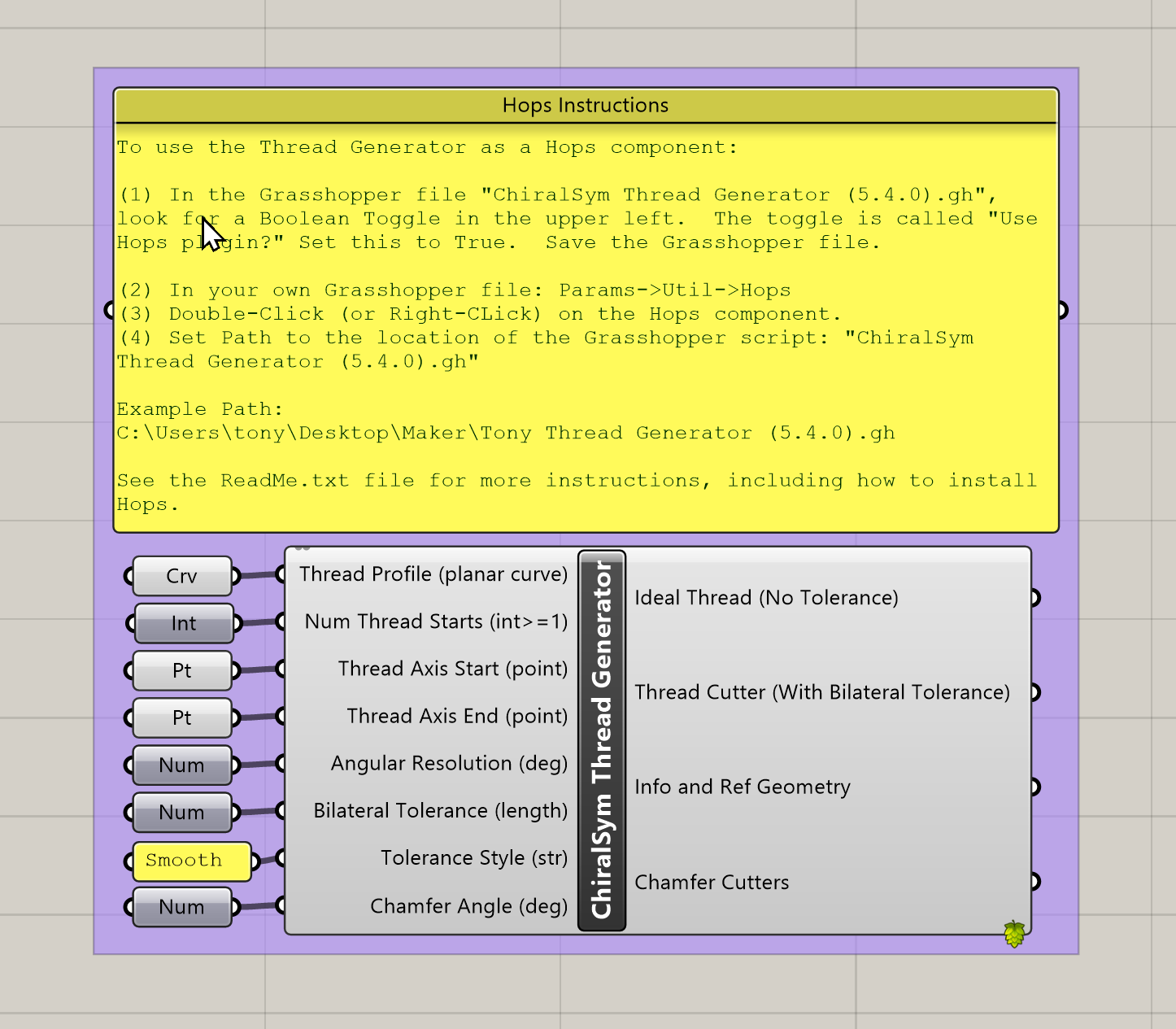

Updated to version 5.4.0.
Now can be easily used as a Hops component in Grasshopper. This is a much more convenient way to include the Thread Generator in your own Grasshopper scripts.
The Thread Generator now has a Boolean Toggle that you can set to True if you want to use it as a Hops component. Otherwise, set the toggle to False. The toggle is called,“Use Hops plugin?”
Rhino_vjz63yxJgl
See the ReadMe.txt for more details.
Let me know if you have problems, find bugs, or have suggestions.
Released as open-source under an MIT License.
ChiralSym Thread Generator (5.4.0).zip (7.2 MB)
