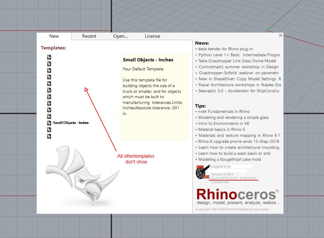

I just updated to 6.24. When I start up only one template displays. When I mouse over the area of the template name, the right panel displays the template information. Odd that one would display and not the others.

Hm, I suppose the one that shows is the default template(?) Can you just try rebooting and see if that clears any cobwebs?
No go. Now none show. Even though scrolling over the templates areas gives their info on the right pane, they cannot be selected. However they are available from “New”.
Additional info. This is affecting WIP7 also.

I would try a setting in your nvidia driver.
Under manage 3d tab, select programs and add (or choose) rhino executable. Then down a bit for opengl rendering, use the dropdown to choose the actual 2070 card…
See if that helps. If so, you could try it on the global tab.
May i ask, why the intel graphics? Are you actually using it for something? If not, i would disable it…
I checked on that. No go.
I do not have the GeForce Experience installed, (it has been described as problematic with Rhino.) and my nVidia 3D control does not offer card specific options–model name. It has:
Use Global setting (High-performance NVIDIA processor)
Integrated graphics.
This is a MSI GS75 Stealth 9SF laptop, and think the integrated graphics are just listed in the sysinfo, but already disabled. All options for it are grayed out when it is selected in the dropdown.

However, enabled or disabled, produces no change, the templates are not displayed. I’m not certain when this began or if it is the result of any updates or changes. But whatever it is, it’s affecting 6&7 the same.
