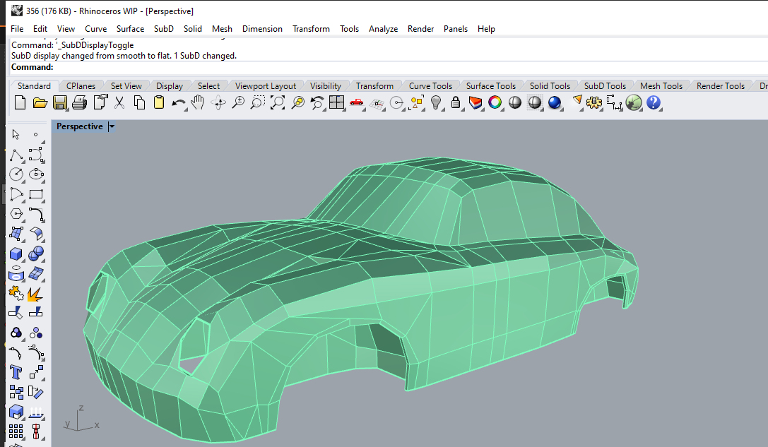

Quite a few years ago I made a Porsche 356 A with the body done in TSplines.
Out of curiosity, today I imported into Rhino 7 the body and it worked great, I am very pleased.
A friend I made since the original Tsplines model was created has the real thing, but the B version and I think I will surprise him by Christmas with a replica of his car, registration and all :slight_smile: I am going to do the A->B version modifications in Rhino 7

One thing that might be interesting to see is the progression of the model with the thumbnails of the incrementally saved versions. It says Rhino 6 (default opening program) but in fact is the WIP

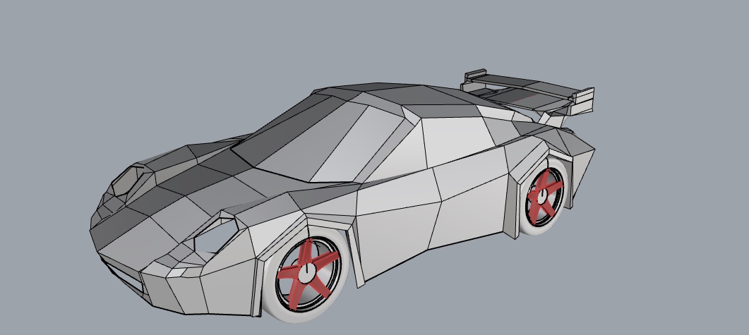

I am by no means an expert and this workflow might have some severe drawbacks, but it worked, The final subdivision of the model was to give it globally more “tension” so that future small changes could be make locally without perturbing the overall shape. Not a good approach , I know ! The wheel was imported from a previous file. One thing that you can do with subD is, from a generic car , transform it in many different types. Looking forward to your experiments… Cheers

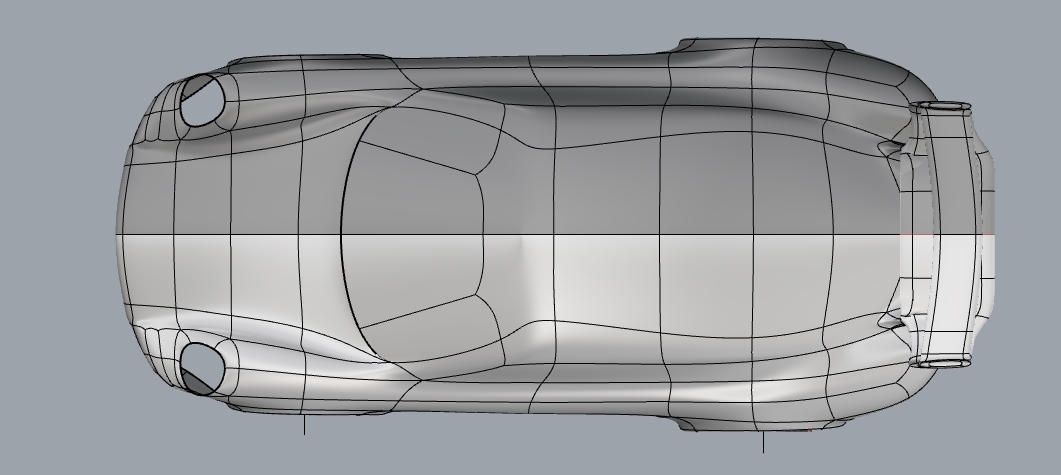

here goes another car made in around 1 hour after the last post, loosely based in a Porsche 996. Really a joy to model in SubD.
The resilience of the SubD system like its ability to use non square faces is a tremendous plus.
Kind of a dream to have a native SubD toolset in Rhino :ok_hand:

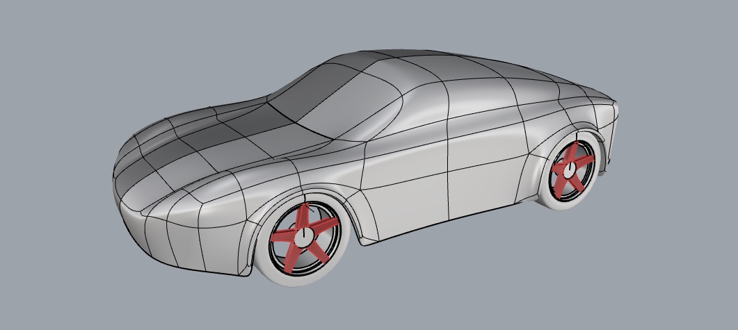

Another hour of work today
awesome, can you name that same tune with 50% less faces?
remember lightness= smoothness= easy to editness.
great workflow, I’d just go through and delete edges until it falls apart and then put that last edge back in.
yep- I’m finding a sweet spot with SubD whereas the main forms are built in SubD then I save a copy of it for later if needed, and do the detailing in nurbs-
looking really good… if you see pinching spots, you may need to chase the edge out a bit further-
remember adding edges you need is not bad… adding too many edges you don’t is.
