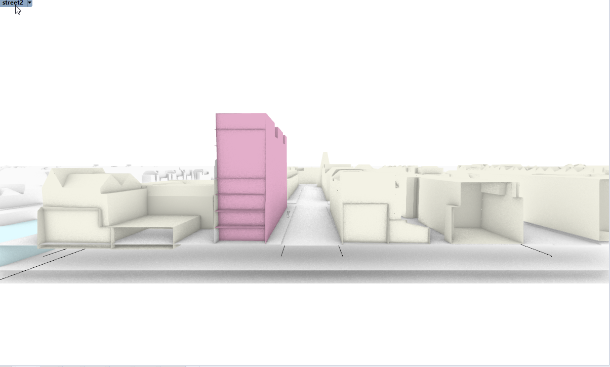

Hi everyone, is there some progress in this? I’m working on a large building an the clipping is EXTREMLY infuriating. It became even worse after I started doiing some simple Ladybug analysis. After I placed a Brep component to GH and referenced a few Breps, the camera clipping just clips the whole model. Only remedy is (!) deleting the brep component from GH. When I tried a Mesh component instead, the camera clipping got to normal. What is going on?

the same problem occurs with me, in rhino 6 and 7WIP, even after updating my video card driver.NVIDIA GeForce GTX 1060 3GB (NVidia).
This view is in an changed arctic but it also occurs in rendered view, traditional artic.

Actually I found this short thread which describes the same problem and presents a usable workaround, though I had to delete my ground plane. I would like it better if the underlying issue could be handled, as this is not the first time I have encountered it.

CLICK ON RENDERED VIEW AND CHANGE THE “GROUND PLANE SETTINGS” TO “CUSTOM”

Your settings have the ground plane settings off. Already at the beginning of this thread, I mentioned that if you turn the ground plane off the clipping disappears.
Now I have Rhino 7 and I picked up the same file I used to start this thread. The problem persists in that file. It is disappointing that after three versions and 3 years this is apparently not solved.
Even changing the settings to custom (I only tested in Ghosted display mode) as you suggest the problem persists.

  1. You may want to check for lost objects distant from the scene (or from the origin)
  2. You may want to check for distant entities in imported or linked files or blocks.
  3. You may want to move your scene closer to the origin
  4. You may want to turn off the ground plane (apparently now through the Options>>View)
  5. You may want to hide your camera.

Often it seems related to distance from the Word origin. Either the scene is set very far from the origin, or there are lost entities far from the origin. These lost entities can also be in imported or linked files or block. This may be aggravated if the file is in millimeters and the distances are of several kilometers.
One solution may be to move your scene closer to the origin, but this may be inconvenient especially in topographical survey or other files that need to be georeferenced.
I was able to replicate this in a file done from scratch with no units. I modelled a cylinder with radius 60 units at the origin, and a small cube about 2000 units away. When I delete the cube, the problem disappears. These are very minor distances in the files I normally model. Again, this a file done in Rhino 5 at the beginning of this thread 3 years ago.
It was referred that it may have to do with hardware limitations. I am less inclined to believe this because similar models do not have the same issue.
The other reason that I do not think it is a hardware limitation is that once it starts occurring, it seems to persist even after deleting and purging all geometry, keeping extremely basic geometry placeholders (as in the images at the beginning of this thread).
Another issue that affects the problem, in my test files, is showing the camera. In one of the test files, the view is ok initially but once the Camera>>Show, the clipping happens even more obviously (i.e. clipping the geometry 41000 milimeters from the camera). When the camera is hidden, the clipping is about 5000 milimeters from the camera.

One thing that I have noticed today, is that turning the GroundPlane = Off in the Ground Plane menu (which used to improve the situation) does not work on the file I am testing. The clipping plane only disappears when you turn off through the Display Mode options (Options>>View>>Display Modes>>Ghosted>>Ground plane settings = Off). I assumed this was the same “Offing” but apparently is different.
