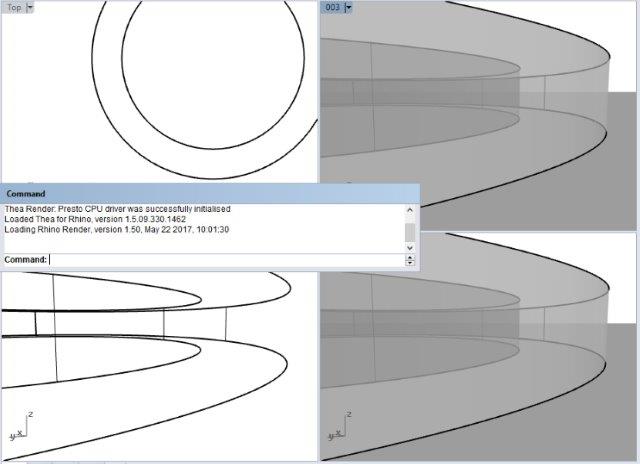

When I zoom extended I found that I had an object in a galaxy far away. I deleted it and -viewrestore’d my 003 view on standard perspective viewport and it looked alright. I turned -camera to show and went to the standard 4 tiled viewports… to my surprise the top-right viewport where the 003 saved view originally was still showing the clipping plane, while the bottom-right viewport where I had now restored the 003 view was showing it ok. The camera icon (on the top view) showed the near clipping plane as it should be (i.e. the bottom-right viewport). I tried to restore the 003 view on the top-right viewport, but it did not change. I then restored the 003 view on the bottom-left viewport and it kept the clipping plane.

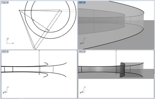

Then with the top-right viewport selected, I used -Camera and Toggle’d and all viewports looked the same, without the clipping plane, but when I toggle’d the -Camera again, the top-right viewport looked ok, but the other reverted to the clipping plane…
180801%20same%20view%20diffResult2
I have no idea what is going on here but there’s something strange…

When I open the file it looks like this. check also that groundplane is on.
180808%20open%20file
after toggling camera it looks like this. Note that the near clipping plane looks ok also (and even further from the objects than yours). Nevertheless, two viewports are clipped.
180808%20Camera%20t
when I toggle the camera on other viewport this is what it looks like
180808%20Camera%20t2
When I turn groundplane off, all views are ok and the near clipping plane seems close to yours.
180808%20Groundplane%20off
Among the strange things, the strangest is that there’s one viewport that look ok while the others don’t.
