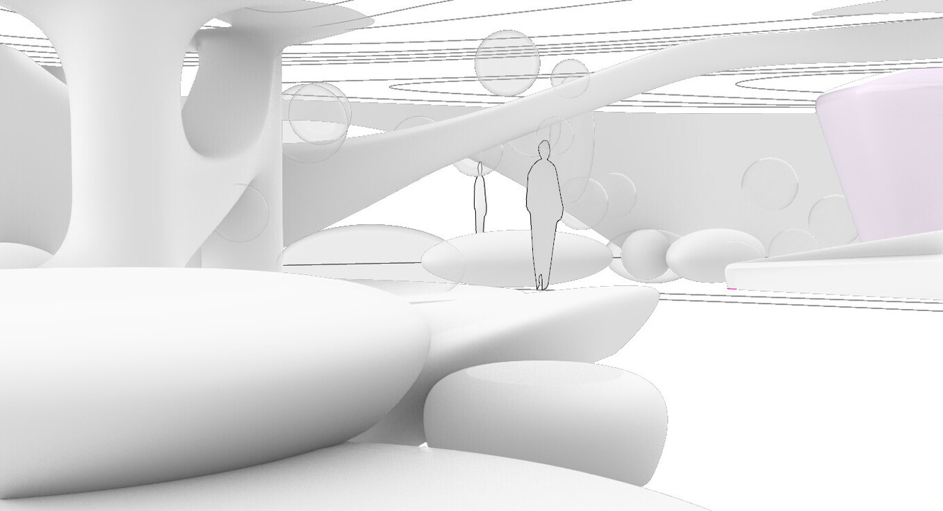

I am having problems saving out a high res image from my viewport. I set up the view like this:
That is how it looks if I manually take a screenshot^
If I use “ViewCaptureToFile” or “ViewCaptureToClipboard” and select any resolution higher than the viewport (which is too low for what I require) I get a mystery clipping plane effect:
Any ideas on how to get a high resolution output without chopping away the foreground of my perspective?

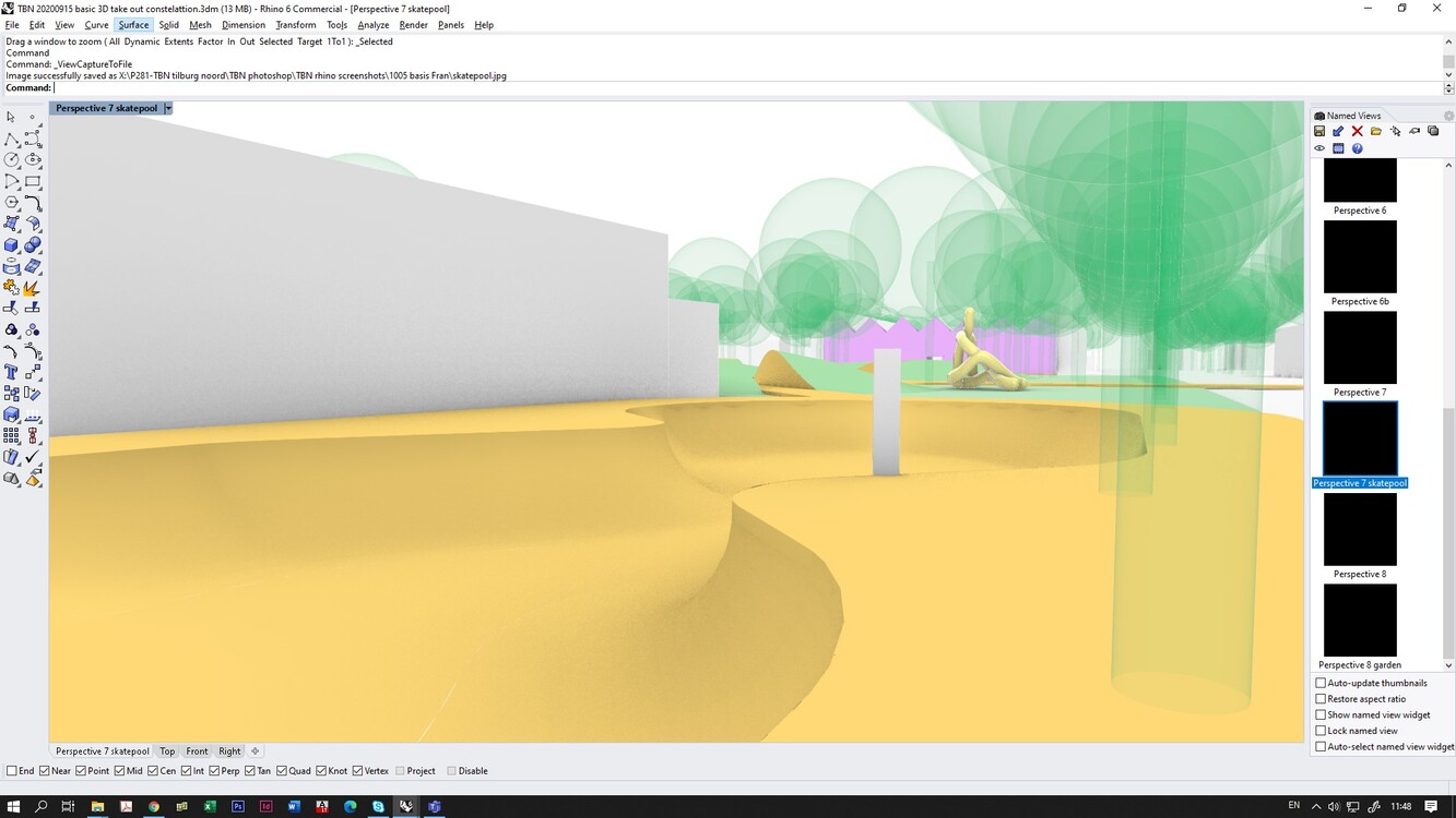

Hallo John, I have the same problem also - all the time! Here and example.
TBN 20200915 basic 3D take out constelattion.3dm (13.3 MB)
