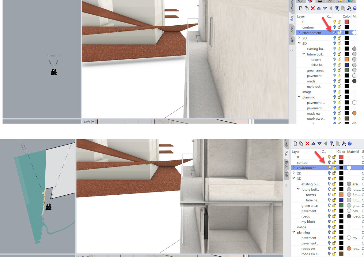

my rhino started to make an odd thing while in perspective view and zooming in inside the model.
it wont show any metarial that it cuts with camera
this happened in 2 diffrenet computers and sevrel diffrent models.

Hello - does a shaded viewport show the same problem? And a full rendering?
it does the same in shaded viewport
render works fine.
I see, thanks - we’ve had examples of this sent in, one of which I am looking at now and the problem does not show up in that file in our current build - yours looks like a large and complicated model - is there any chance we can get the file from you (www.rhino3d.com/upload, with a link back here in your comments) , or a simpler/less confidential one that shows the problem?

its like when the camera “inside” the wall then instade of solid it shows as wireframe

Hello- in your example above, the plain box displays correctly until the camera is inside the wall, is that correct? That last is expected, btw, but that is not the same problem as your original post - I would like to see an example of that.
@elihoabadi123 - it looks like your upload failed - please open the file, SaveSmall
, and then zip the resulting file and try again.
@elihoabadi123 - I have your model - thanks for doing that again - there is no named view that looks like it corresponds to what your screen shots show. So far I am not able to find a view that clips as you show.
You might also do better if you hide the terrain for views where that is not visible to reduce the scene’s dimensions.

Did you try hiding all the terrain and distant objects for the close-in views? You can use Snapshots
for setting up various scenarios for each shot.
@elihoabadi123 I see the problem in the last file you posted. My earlier suggestion of hiding a large part of the model seems to fix the problem here-
You can see that the camera is very small compared to the overall extents of the scene if everything is showing and there is a lot of geometry behind the camera, which tends to be a problem, I believe, too.

Hello - I can send you the file, but you should be able to fix it yourself - can you try turning off the Environment layer and hiding other objects that are far outside the visible scene? I think there are some curves and so on. Does that do it or no?

hey pascal, thank you very much for the help.
looks like the camara and the enviorment solved the problem.
however it still shows a bit “cut” so i was wondering if there is a command to reset camara settings.5
