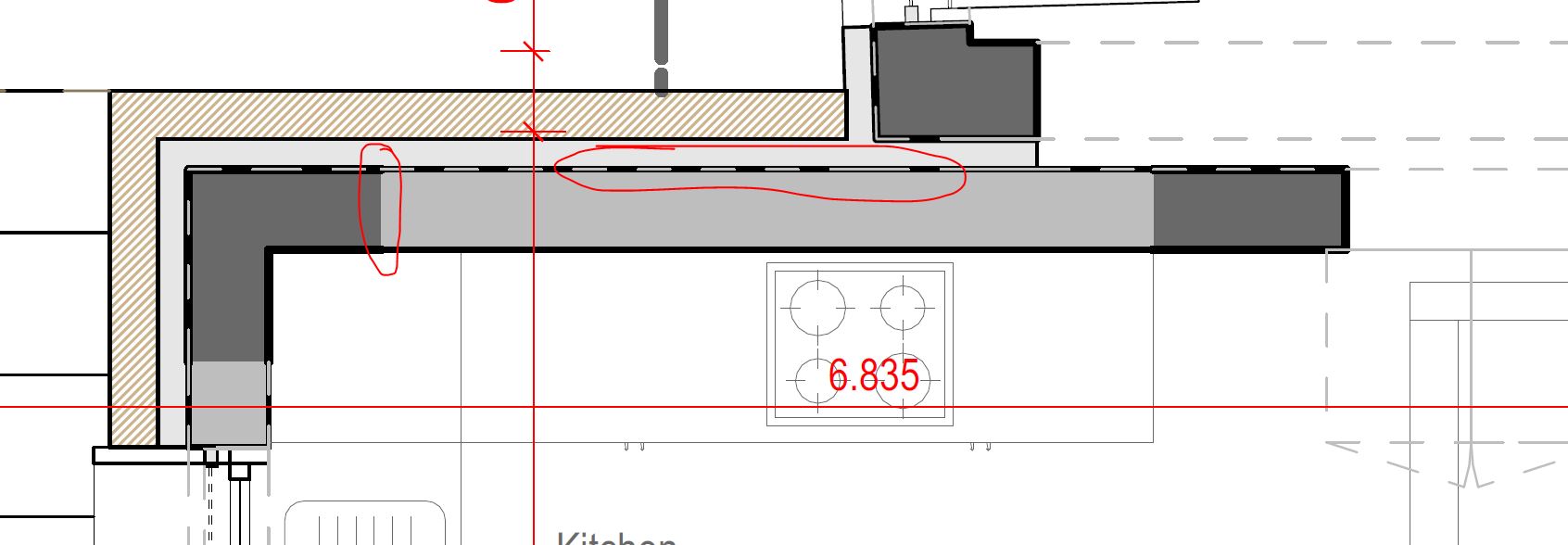

Lastly, vectors have some weird artifacts. These results are with 600dpi resolution in print dialog.
These might be to small geometry
This is where two walls meet each other and touch with one column.
These are stool feet in projection.
Please let me know if i am missing something, how to improve if possible the above issues, or any workarounds to current limitations are welcome, be it visualarq or rhino tips.

Have you tried to increase the dpi resolution? please send me some sample files that we can review to improve these results.

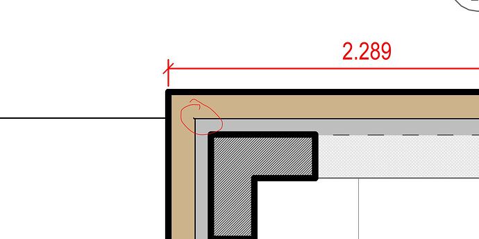

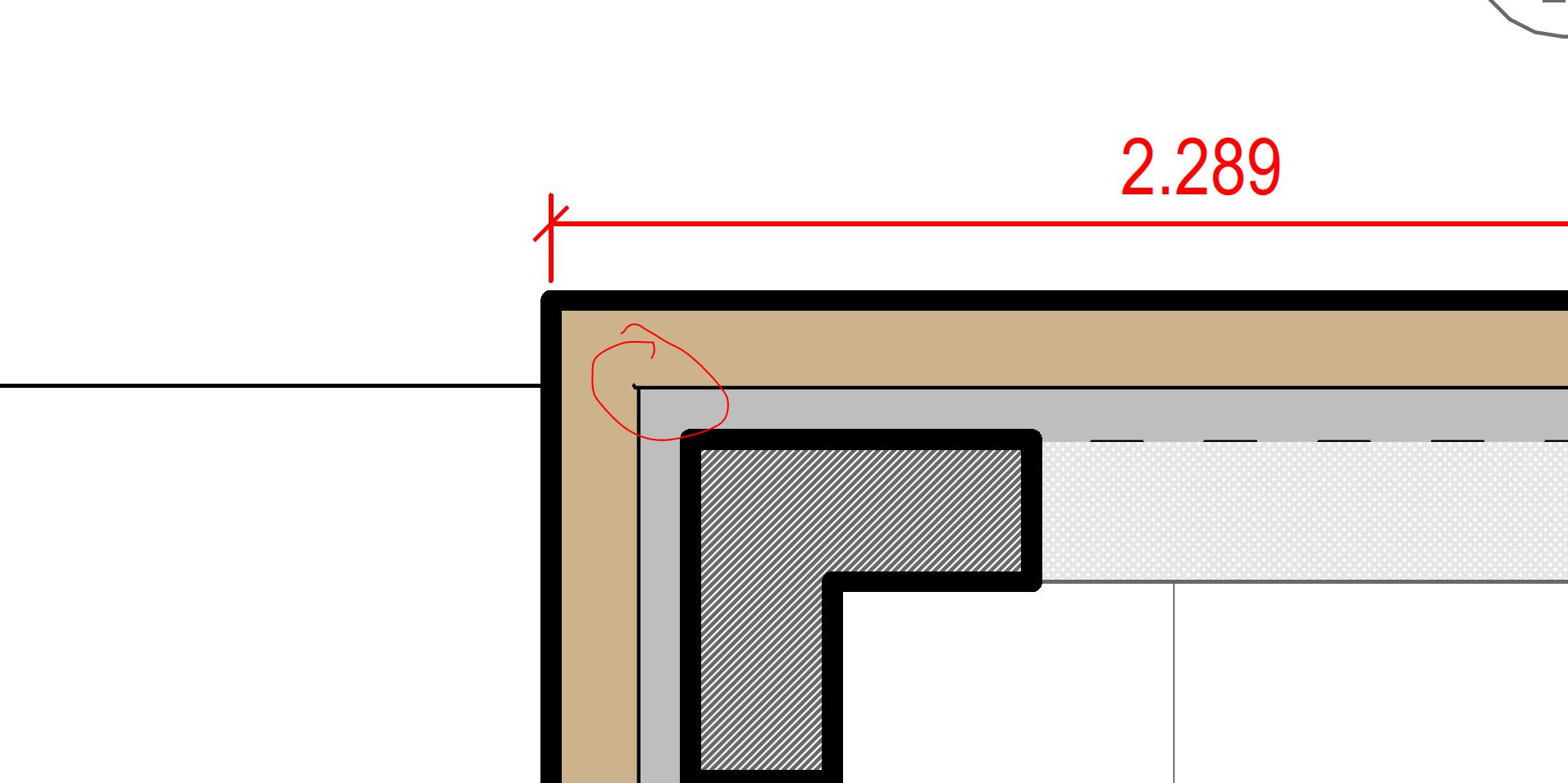

See the following example regarding a wall style. Here are my settings where almost everything is set to be by Layer.
And this is a layout i have set up for the ground floor with print preview off and two wall of the same style, the right one getting sectioned the left is shorter and is not sectioned. This plan is generated real time, i have set plan view ground floor from levels, and display mode hidden.
And the same layout print preview enabled
Here projections are displayed according to print color and sections are not, but they do print correctly to pdf. I was expecting with my settings to see also sectioned items according to print color set to their layer.

I tried 1200 dpi and this still happens to really small objects, like faucets, chair feet etc. I would think it is easy to reproduce the issue if you just print in plan view in scale 1.50 items from the default library, like kitchen sink from elements, stool rectangular from furniture, or any other with small size parts.
