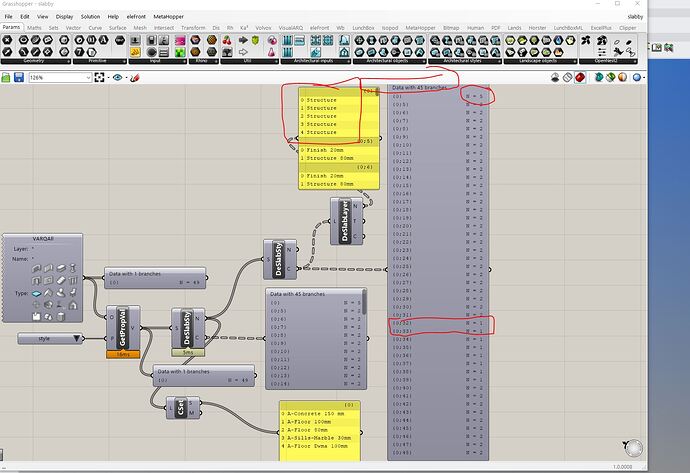

Grasshopper Tree Stucture Output - Output Layers
deconstruct slab style outputs weird tree structure, where besides the weird tree branch paths numbers [0], [6] etc, output C slab style components has unexpected items count in the first branch, since no slab has six layers named Concrete 150mm.
Same happens with other deconstruct components.
Am i missing something or is this a bug?

To better understand what’s going on with the deconstruct slab component and verify whether it’s a bug or just unexpected behavior, could you please share the 3dm Rhino model and .gh Grasshopper definition files?
Regarding the extra slab layers i cannot recreate the issue with VA defaults, thus i attach a file with the slabs only ( i cannot share the working file with all the items).
slabby.gh (14.0 KB)
slabs.3dm (8.6 MB)
So in my understanding, Branch [0] that now has 5 items ie the layers of the one layered concrete 150mm slab, should be [0;0] with N=1, [0;1] with N=1, [0;2] with N=1, [0;3] with N=1 and [0;4] with N=1, then both layers and tree branches paths would be ok.
See also the output tree paths that still happens with default items.
Why is the first branch path [0] instead of [0;0]?
VA defaults.3dm (6.6 MB)
VA defaults.gh (13.1 KB)

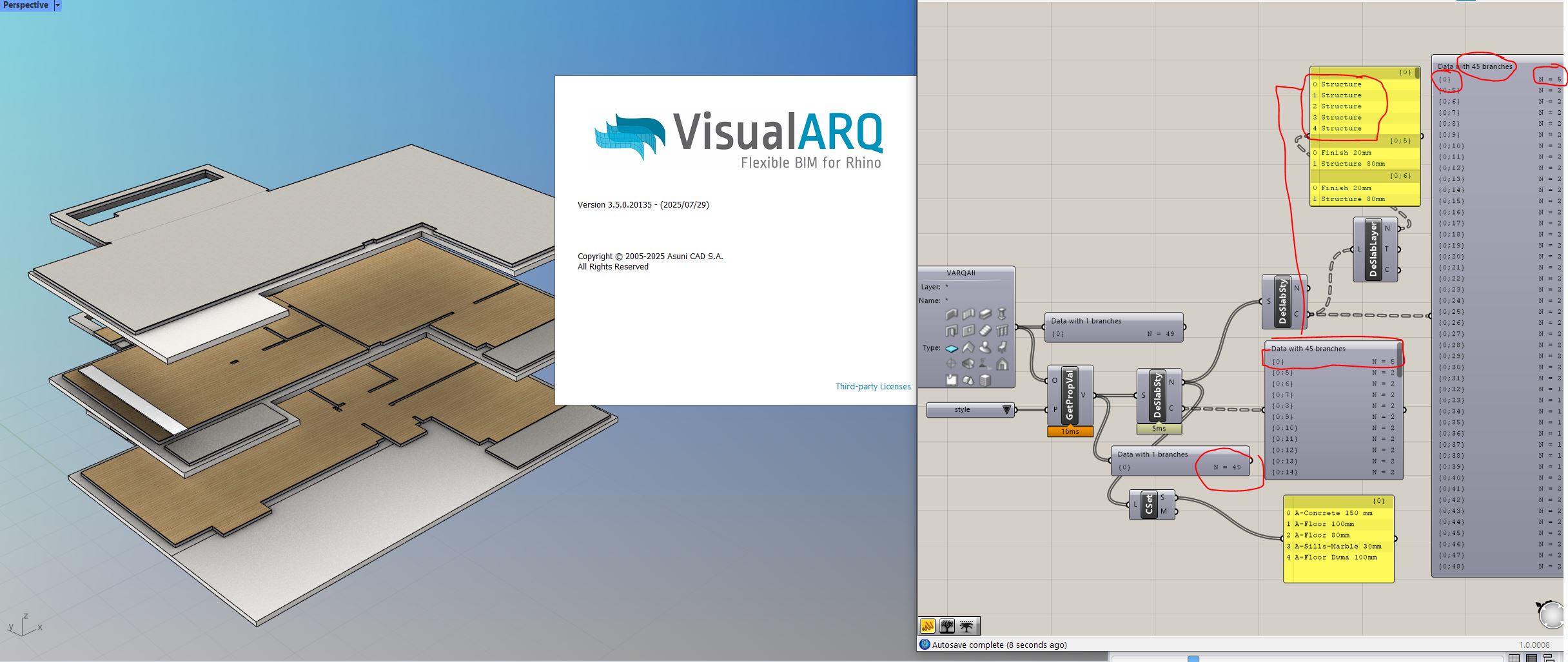

Unfortunately the bug is still there in the new 3.5 release
Deconstruct slab outputs wrong tree structure, branch paths and branch items.
I found a way to demonstrate what happens, you can see in the following video.
It seems that issue happens when you have one layered slab styles in two or more consecutive levels. If that’s the case branches are merged, branch items mixed, or tree structure is complete lost resulting in unpredictable and not logical outputs. Also if the first slab is one layered the first branch path is one dimensional.
p.s.I doubt this is a feature and not a bug, but if that’s the case please someone explain me the logic.

i tested version 3.7 RC2 and the tree structure is still bugged.
i examined further to see if all items are bugged, and my quick tests reveals that it is the walls and the slabs that have this issue. The other types seem to be ok. I added in my working file many styles per element and i made sure these were added in multiple levels, because somehow it seems to me that levels are related to the issue (see previous post).
Also i thought maybe pipeline component is to blame, but same thing happens if i reference the walls.
i could not test everything (e.g. roofs).
Please consider moving this bug up in the priority list.
