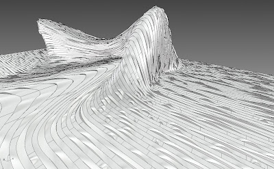

I have been struggling with this logic for a little while now, I am trying to create a definition to produce surfaces similar to the image attached. I have a feeling I might be approaching it from the wrong angle so would like to get another perspective if possible?
