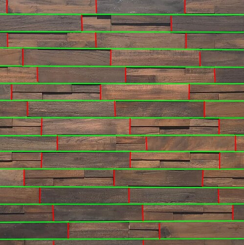

Hi, I am currently working on a project where I would like to replicate the pattern shown in the image. I have tried using substrate to divide a square into multiple rectangles, which sort of works, however the devisions are too square, and I would like to have vertical strips. I also used the random quad panel component from Lunchbox, but these are only random in height, not in width. Could someone please help me out figuring out to create such a pattern? Much appreciated!
I see very regular division in horizontal stripes:
followed by a regular vertical division in bricks with equal lengths:
and as last step you have a final level of subdivisions where some bricks gets split using a main grid that dives it in two horizontally and in 3 vertically, where parts can get merged together:
[for the ones in grey, we see only a portion of division, so can’t really say which type they are]
I would also note that in each row of bricks, neighbors of a split brick never get split
[edit] neighboring rows of bricks appear to be always translated by +/- 1/6 or 1/3 of total brick length
