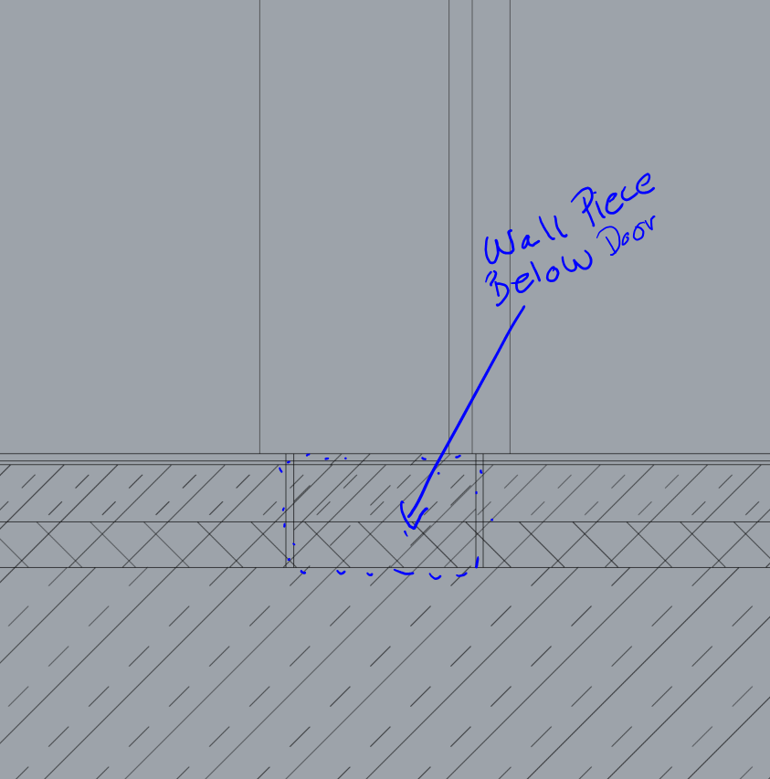

we have recently decided to try va for a new project and i’m wondering if meanwhile there is a feature to connect wall cores to slabs (concrete/conrete).so far we put the walls on the slab and create single slabs for each room for the screed. thats a rather painfull workaround as it leaves wall pieces below door-openings which then need to be removed by substracted solids and also the need to redraw the basecurve for the scred slabs each time a wall is moved.
if there is no tool for this yet maybe someone could give me a tip on what the best practice for this problem would look like.
thank you

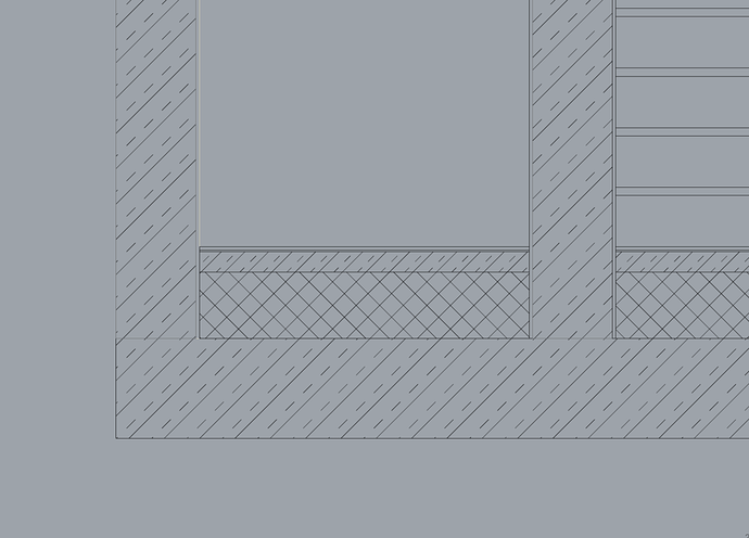

I use the same method, at doors I extend walls downwards. When changing the outline of walls I use control points for refining slabs (both, construction and flooring):
Cheers, Jaro
Hi Jaro,
thanks for your answer. What exactly do you mean when you say “extend walls downwards”?
Hello Linus,
Take a look:
I have to separate slabs, one for construction and one for flooring. This way you can have different floorings in various rooms with the same construction slab. Then, I put doors - but here is the only drawback, I have to set different level for doors, as normally they would be put at the top of construction. Or you can do it any other way, just moving doors upwards, for example. The next things are floorings, without doorsteps, this is the final move. Of course, you could put them at any time, but every change would cost you additional work. So, at doorsteps I add rectangles and join them with the flooring I want. Finally I extend wall downwards (you can’t see this at the picture, but I choose the “bottom” option). That’s all, I have walls standing on a slab, with floorings on all surfaces.
edit: this way you can also decide what layer of a wall starts on whal level, you can offset bottoms as you wish - for example, you can have final coating starting just above flooring
Cheers, Jaro
