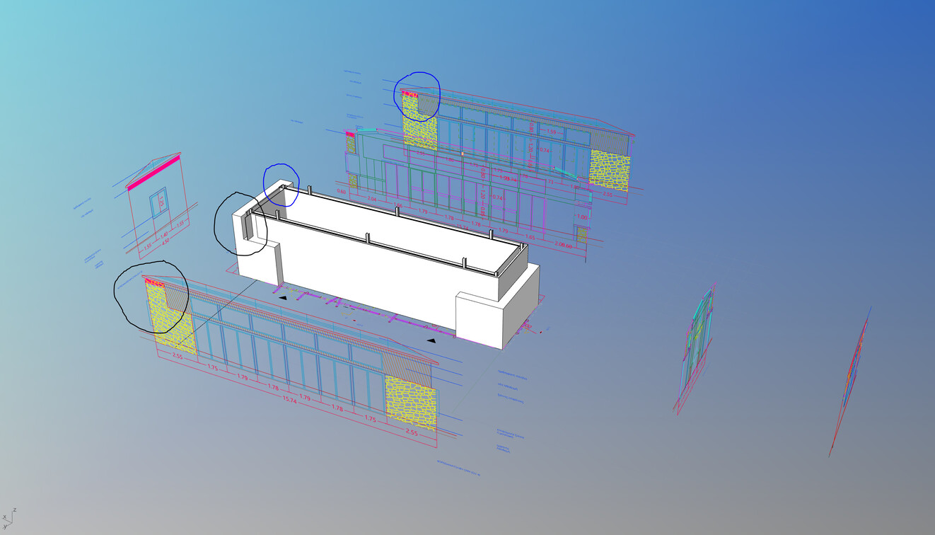

Hi @fsalla, I apologize for the delay on my response to your suggestions! I am trying to work with as many as possible different parts of VisualArq and that’s the reason.
I have proceeded with the No1 way (of your suggestions). But, as seen in the images below, I have divided the wall to different parts (4 parts) for each different situation in each section ( #1 layer1 bottom-offset: 0, #2 bottom-offset: 2.40m, #3 bottom-offset: 2.40m, #4 bottom-offset: 3.763). Question #1: Is this way acceptable (would you suggest it) in terms of better BIM model configuration?
Another thing I have noticed is that: VisualArq is certainly “Clever” and calculates the intersections between walls automatically. As you can see below (IMG-1) even if I have modelled the wall #4 according to the 2D elevation (with the black circle on it), calculated differently than expected the wall lenght and intersection with the other walls. Question #2: How is it possible to control those intersections and calculations of VA?
You can see how the VA-calculations control the actual Wall-connections.

Hi @zabrielza, The way you are managing this looks fine.
You need to define the “Construction” details of each wall layer. There is “Normal” and “Core” type. Core layers will tend to intersect each other in wal connections, while the “Normal” ones will wrap around them. That being said, there might be different intersection solutions anyway, so you can explore them by selecting the two walls that intersect, and checking the Wall Join options (“Sort order”) in the Properties panel:

I see the problem. These are two walls that are aligned in parallel, and for that reason, they can’t intersect. I’d rather create 1 wall that integrates the layers of both walls, than creating 2 walls aligned alongside, which may cause intersection issues.
@fsalla I can understand. Thanks for the reply! I can find the creation of a single wall with 5 layers instead of 2 walls (stone-wall and a 4-layer wall), a bit problematic for two reasons:
  1. The first one has to do with the fact that the wall-stone is a pre-existing element. On the other hand the inner wall (of 4 layers) in a new element and we would prefer it to be controllable without interacting with the stone-wall. In terms of better BIM-configuration we would prefer 2 separate walls, am I right? We have to be certain about being able to do micro-changes in the inner-wall without the need of re-creating each time the actual wall-style.
  2. The other thing is that the stone-wall has various forms (see the picture below) and that leads to the creation of a 5-layer wall element for each width “of a state” but there is a problem: The 2nd layer, wooden-exterior layer is on top of the stone-wall, so we would need to automatically change the height of the wooden-layer from the height of the below-offset value of stone-wall. Also, how could we place one on top of the other?

Hi @fsalla. I am getting familiar with VisualArq and this is very pleasant. I have continued with the workaround below:
I have created 2 wall styles. a) Double Wall (with stone on the outer layer) b) Single Wall (with wooden Panel on the outer layer), Please see the images below.
The single Wall, when needed according to the 2D drawings, in on top of the Double Wall, creating this way a stacked Wall (but with two separate objects).
Q1: Could you suggest a workaround to combine them in as single component? I am thinking of using grasshopper to combine them and placing the Wall by clicking on start and end with mouse just like placing a normal wall, is this possible somehow?
Q2: Do you think that as bim configuration having walls on top of others is a good solution?

Hi @zabrielza
Having two walls aligned one to another is something that right now will turn into intersection issues. I know in the real world you can find similar situations, but right now VisualARQ walls are not meant to be used that way, and I’ll try to avoid it. We may consider finding a solution for that in future versions. There are several workarounds as described above.
Maybe this is a good solution. Just place a wall on top of each other in the same way you would put a box on top of another.
Just need to be sure they align properly.
VisualARQ doesn’t have such a concept. But you can get similar results by playing with the wall layer offsets, or just placing 2 different walls one on top of the other, as you have tried afterward.
If you are playing with Rhino Inside option, take into account that in order to turn a Revit wall into a VisualARQ’s wall, you can only use the common parameters to generate them. For example, VisualARQ walls don’t have 3D structural components right now (it’s planned for future versions), so you won’t be able to turn a Revit wall with 3D studs into a VisualARQ. You can find workarounds for that though (using columns, beams, or extrusions for these inner components).
This is controlled with the wall joints options, in the Properties panel. But avoid parallel walls, please.
You can do that if you have different wall styles. If you want to turn a 3 layer wall into a 5 layer wall, just need to have 2 wall styles created in your document (with 3 and 5 layers), and switch from one to another from the properties panel of the wall.
