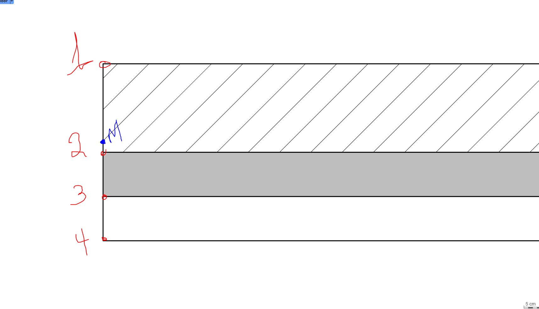

This is my last attempt to describe it.
This is a three layered wall or slab.
There must be an option to choose where the alignment happens. One should be able to choose point 1, 2, 3 or 4.
At the moment inside [meaning 1] outside [meaning 4] and middle [meaning blue M which is totally irrelevant] offer very basic, if any, meaningful support to draw a multilayered item in plan or any view.
Especially since alignment offset is not available in the style properties and we need to constantly set per item alignment value (see above posts).
Hi @ng5_Alex your request is clear. Thanks!
+1. Thanks @ng5_Alex
