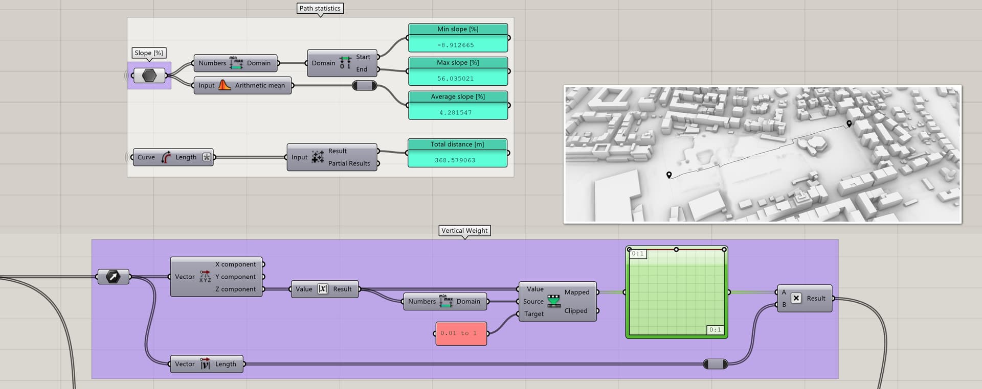

Can I use the vertical distance between mesh edges as weights? That way, I could compute the path with the least vertical deviation. This would be useful for wheelchair paths, amongst others.
For smoothing the shortest path, would it hurt the speed of the algorithm a lot if I add diagonals across the entire mesh (so create 4 triangles out of every square)? If it doesn’t that would make it easier to convert the path into a smooth curve.

FWIW, it’d be pretty trivial to add slope angle as the edge weight to this MeshPaths GHPython component I once wrote (i.e. add another weightMode to the two functions that generate the graph), which implements networkx for the graph computation. You can download the 1.5 version here and unzip it to:
Edit: Here’s a quick implementation of what I was suggesting above. I also added a Smoothen input, which iteratively averages the path vertices and projects them back onto the mesh in Z:
Although I do see a pattern in what the mapping does, I would prefer to have a 0 to 1 slider to mediate between the shortest path and the least slope priority. Do you know how I could incorporate this? I have tried a couple of things with the weight input, but couldn’t get it to work.
