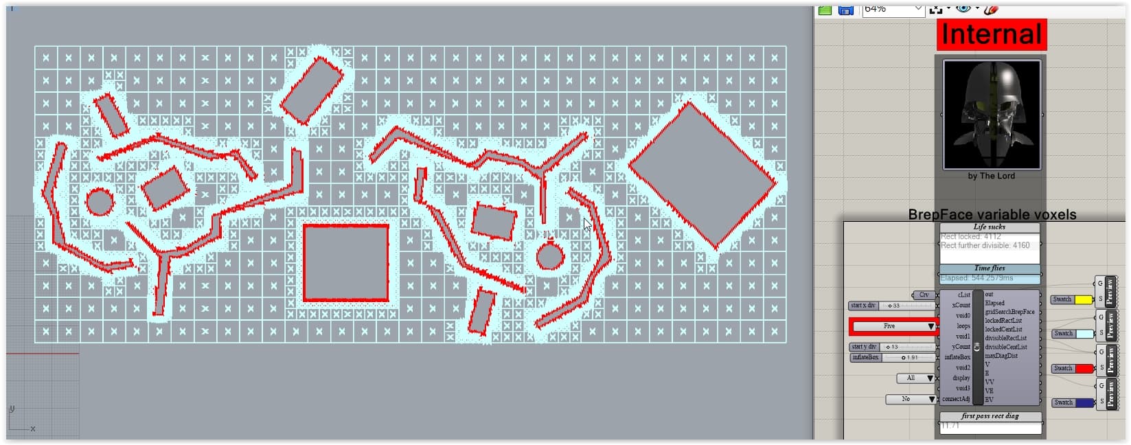

Unless a robust backtracing Method is used (like the one that we use in Graphs [Hamiltonian and the likes]) … a Visiblity Graph is not the equivalent of A-Star shortest route. Wait … in fact you can do a suitable Graph that way … but without code is highly unlikely.
Note: If you are not familiar with coding (level required: expert to pro) don’t attempt to deal with things like these.
Anyway: see a var “voxel” take on a BrepFace (cyan: locked rectangles, red further divisible ones according some Recursion loop value):
The above is using a suitable Class for monitoring all related things:
And a centers Graph based on adjacent Rectangles (NOT the same as a Delauney result by any means) using Intervals Ccx for finding neighbors (1M times faster than some Crv/Crv Ccx approach) . This yields V, E Lists and the classic VV (thus an Adj Matrix (*)), VE, EV Conn Trees > meaning ready to A-Star … etc etc.
Note: PRIOR A-Star you’ll need to find Islands (general case) using solely Recursion on a VV Conn Tree - for more than obvious reasons. This yiels Conn Trees with 2 dim paths (and more than one Adj Matrices). Unless you are not familiar with coding … blah, blah. Here’s an Island:
(*) AdjMatrix from a VV Tree:

I’ll share the current progress shortly.
It works as follows:
  1. The first pass (Loop ==1) yiels a “classic” Face subdivision where: rectangle STATE (see class) is “Locked” (no ccx events with any inner curve) or “Divisible” (ccx events plus the indices of the related curves are stored in the class object ).
  2. Then Recursion: is there’s “Divisibles” around … for each next Loop all “Divisble” Rectanges (Parents) are “split”" in 4 (Children). Each Child is tested (for ccx Events) against ONLY the curves that yielded Ccx Events with Parent. So the “Locked”/“Divisible” STATE is updated etc etc. Recursion exits ONLY if (Loop > Loops) because there’s always “Divisible” Rectangles.
Note: Since we monitor various things a suitable Class is required: So anything in 1/2 is using objects defined by the Class.
Tip: if you attempt the visiblity way … DON’T use stupid rectangles and the likes. Use instead the most complex Polylines (i.e. convex + concave) imaginable. Then … well … use Curves (that’s a bit tricky: requires a bounce solver of some sort).
