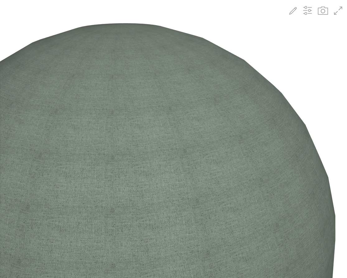

I just tested the material and it worked for me.
Your screen shot looks correct and similar to how its displayed bt grasshopper. However, the defintion when uploaded to Shapediver displays most the colours incorrectly.

Here is the material rendered with the custom environment:

Rendering in Rhino is always a bit different from what you get in ShapeDiver but I don’t see anything unusual. It seems that the material looks darker due to the repetition of the texture.
Try increasing the scale of the mapping and learn more about materials and mapping in this tutorial.
