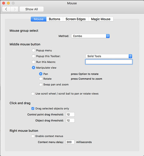

(3012294) #5
@Toby Here are the settings for my mouse.

#6
As far as I can see this works only if you use the “floating window” version of the options dialog.
With command options in the sidebar I have the same behavior (completes command).
