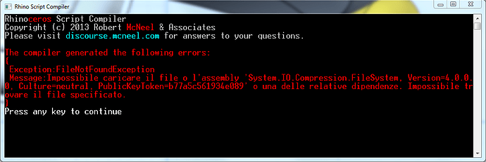

hello Steave
I get this error in the compilation
I have to install NETFramework 4.5?
win 7 64 bit
Ciao Riccardo
Hi Riccardo,
It is hard to tell from that error. Did you install .NET 4.5?

Hi Steve,
I’ve first tried it without the .Net 4.5 just for testing and got the same error like Riccardo. After install of that update it works like expected. My Python Scripts now also work correct (without evoking EditPythonScript first).
Thanks for the update!

Hello Steave
there was no net framework4.5
is installed everything works out
thanks
