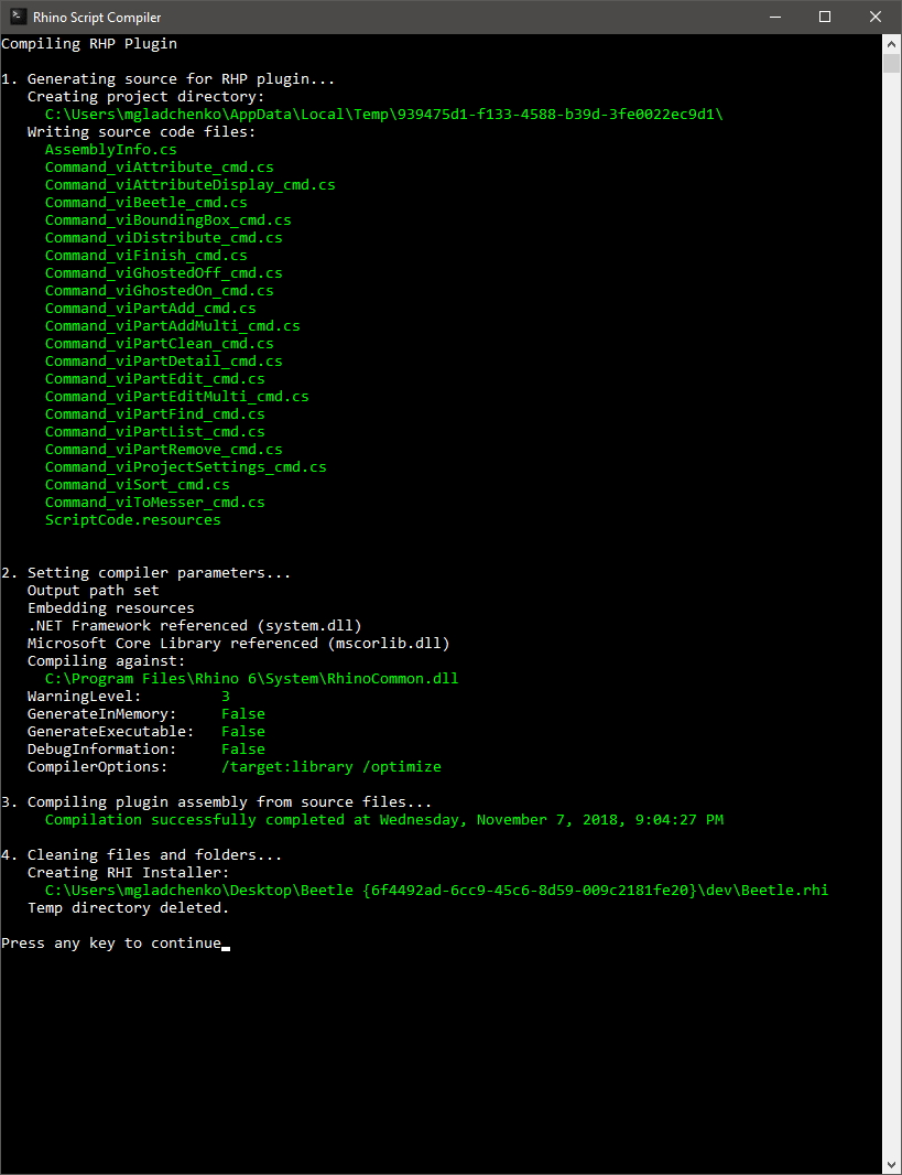

I am trying to find how to add the images into the build
Inside of my scripts, they are all references
dir = os.path.dirname(__file__)
drawing.Bitmap(os.path.join(dir, 'icons', ImgDic.get(PartClass)))
So they do work relative.
But I cannot figure out how to add them to the project inside of compiler
This folder has 34 files in it, but since it’s not a .rhb or .py I cannot select them
If they need to exist at the root level overall I am fine with that even thou it’s a bit messy, but still, need a way to add them.
Also, how do I add the toolbar inside the compiler as well? Same issue, since the file is .rui
no way of seeing it…
Thanks for yout help!
Hi @mikhail,
you cannot add these files directly from the compiler yet. If you build the plugin, choose to create a rhi file. Once you have it, rename it to zip and add the files manually to the zip archive. If you need to support different versions or have compiled rhp files for multiple rhino versions, follow above guide for the required folder structure.

Was able to get it to compile and get the toolbar “packaged” as per your suggestion.
I am not getting any of the commands to be found.
So I’ve looked around and seen that it is no longer in the python script folder, but rather in the overall plugin folder.
And I am not seeing anything there besides the .rhp and .rui as well as the icons folder (with all the stuff in it). Should I be putting in the _cmd.py files into that rhi/zip file?
Or am I missing something all together?
Did I still need to have the __plugin__.py file as per these instructions?
I did remove all of the RunCommand(True) type statements for all of the files.
I do not need any different rhino versions supports. It’s an in-house toolset to I just need to work on 6.10 (64bit) that came out today.
This is what it looked like after I ran the compiler in case it’s of a relevance
Hi @mikhail, you don’t need either of them. Just the script file is required. The name of the script becomes the registered command name. Example script:
