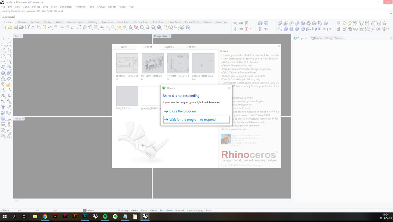

I have just today installed and built a new workstation desktop computer.
Everything is brand new in it.
Today I also installed the new rhino 6 on it, and it worked at first, the first try, but now it crashes at start-up.
I have however noticed it to be connected to a hardware problem. The program only crashes on the screen that is connected via displayport. I have two displays, one hdmi and one displayport.
Rhino works perfectly on my HDMI, but crashes at start-up screen on the displayport display.
What can I do to fix this? Does anyone know?

Just to be clear, I have tested both with - and without all the plugins.
EDIT:
I have a media converter cable (displayport to HDMI) - I don’t know if this would affect the result.

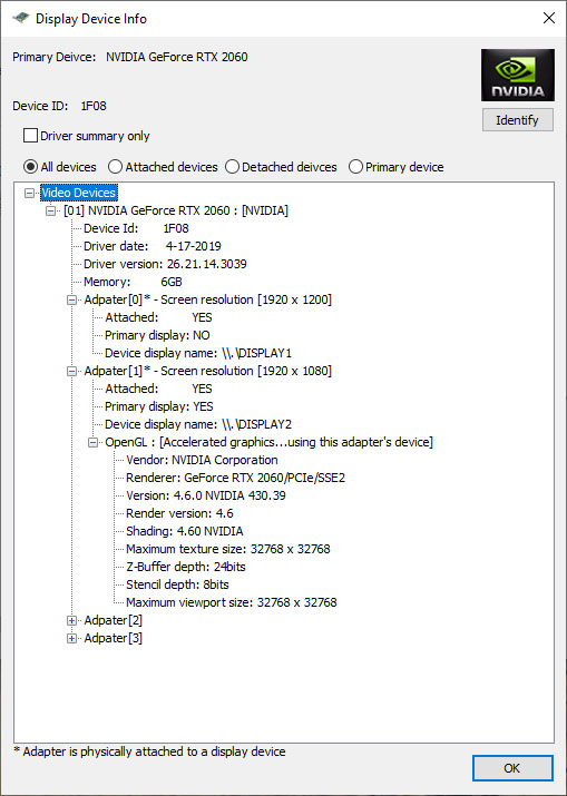

Hi Bartolomeus -
please update your video driver and make sure to do a full ‘Clean install’ of the new driver and see how that goes.
Thank you for your quick response.
I am not sure how to do a “clean install” but I updated my driver and it still doesn’t work.
now it looks like this.

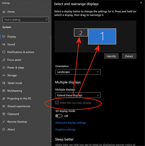

Hello - See if this helps:
I have done the following, still no luck.
Started it in safemode to see the system info.
No external plugins are loaded either.
This is how the sytem info looks like now:

When you have multiple displays, one is designated as the “Primary Display”…which is the one that all applications are bound to… Some applications (like Rhino), remember which monitor they were last run on, so that when you open it again, it starts up on that monitor. But to say something like “I start up application X on Monitor B and it crashes”, isn’t making a lot of sense… Unless… You have some kind of third party application that is managing this.

I have configured my HDMI to HDMI screen to be my main screen, but as I understand it Windows 10 recognizes the DP as a “better” / “more optimized” unit and overrides my configuration. Thus starting some applications on that screen anyway.

When ever Rhino starts on the screen that is connected DP to HDMI it freezes “crashes” on start-up. (Not responding)

No, that’s not how it works. Applications startup based on two things: 1) Which display is configured as the “Main” or “Primary” display, and 2) Which display the application last ran on. Windows doesn’t choose or override anything based on some kind of “better” rating. It might have some kind of default behavior, but once an application has been started, the criteria is based on the above.
So I’m still unsure (not confused), how you’re “starting Rhino up on a specific monitor”… I run Rhino on multiple monitors every day, all day…and which monitor Rhino runs on depends on the two factors I mentioned above. How are you specifically getting/forcing Rhino to use the DP-to-HDMI side of things? You say that Rhino works if you start it up on the HDMI-to-HDMI side…so how are you “switching” between monitors when trying to start Rhino?

When I start Rhino I see the splash screen and the app opens behind it. Then it stays in that state, and nothing else happens. It goes gray and says “not responding”

I have attached a diagnostic tool that I wrote, and I’d like to see what it says/does. Unzip it to your hard disk somewhere and then run DeviceID.exe… Don’t click any of the options, just run it and let the defaults display…Take a screenshot of it and post it here.

Something else… Please run the DeviceID.exe with the DP-HDMI as the Main display, then take a screenshot… Then set the HDMI-HDMI as the main display and run it again and take another screenshot.

Here is the screenshot of the deviceID with DP-HDMI as main:
And HDMI-HDMI as main:
And here is the DMP file as well:
