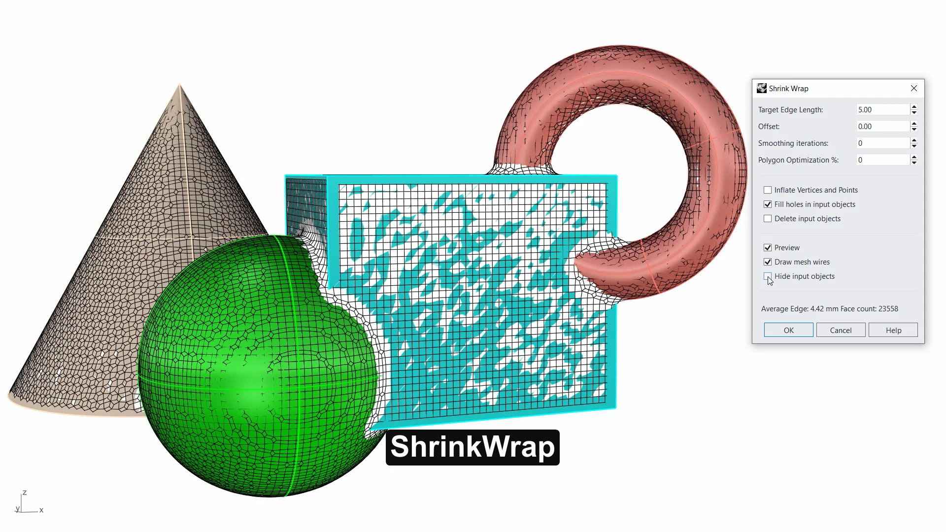

ShrinkWrap lets you create a wrapped mesh from mesh, NURBS geometry, SubD, and Point Clouds. Just about anything!
ShrinkWrap meshes are ideal for creating:
  • Meshes for 3D printing.
  • A solid union mesh from multiple input objects.
  • A solid mesh from 3D scan data fragments.
  • Meshes without internal self intersections.
  • Offset meshes for shell operations
  • Reverse engineering workflows
  • Point cloud meshes
  • Valid closed meshes from broken or often hard to repair geometry.

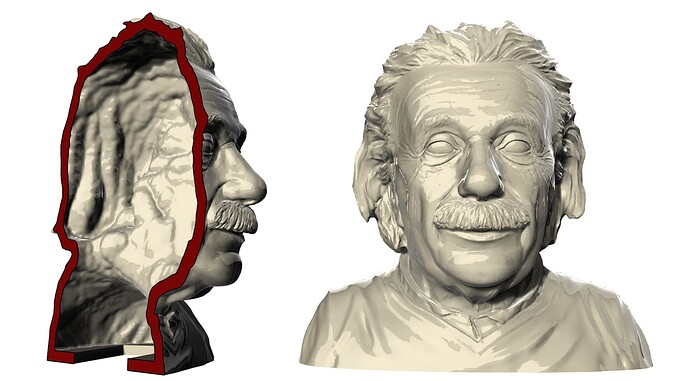

Examples:
Interior shell
