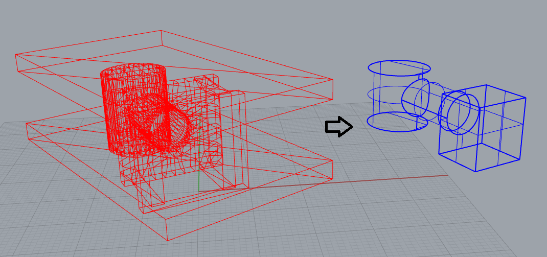

Here are the model and 2 pictures illustrating what I mean. The point -4.00,5.00,8.00 is an internal point.
The blue solid is the desired result. How can I generate this solid?

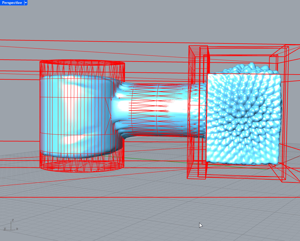

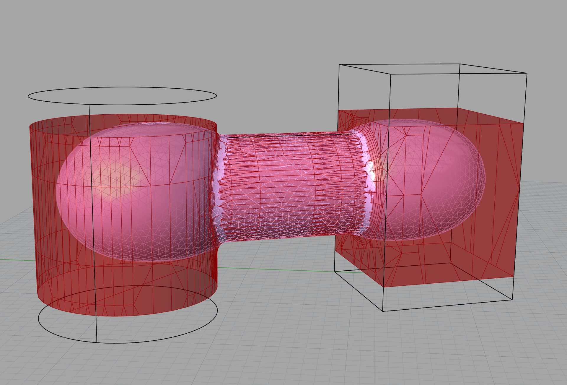

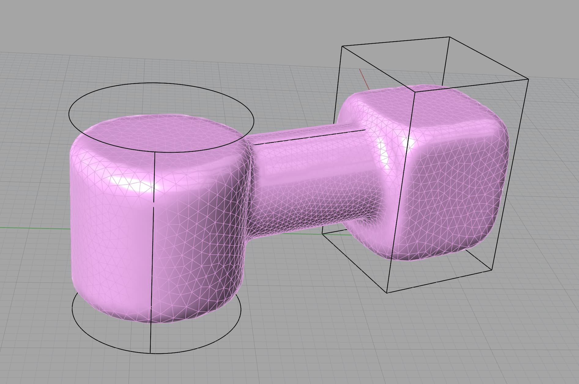

The inflation can be simulated with Kangaroo. The way you set up your walls is problematic since the four vertical walls create a void. I didn0t worry about that and replaced the three voids with two cylinders and a box. I’ve used NURBS for this since I find it’s easier to manipulate in this case. I rounded the edges between the horizontal cylinder and the other two parts since the sharp edge can be a problem for the Solid Collision. The initial ‘balloon’ is a mesh pipe created with Multipipe and subdivided with TriRemesh.
I’m using Rhino 8 and parts of my definition probably won’t work for you in Rhino 6.
inflate_collision_01.gh (389.0 KB)

Yes it is but for the Solid Collision you need the other object which you showed on one of your screenshots above… You can create a union of the vertical cylinder, horizontal cylinder and the four vertical walls. The object above your tunnel does not overlap nicely. I got an invalid mesh after subtracting the two large objects from the mesh union.
Where does the inflation start… You can use a point but this will lead to more stretching and it will likely create a bad mesh. As I wrote above, I used a cylinder / mesh pipe as starting volume instead.
Yes, if the four vertical walls are one box, you could just boolean union the two cylinders and the box. Then if needed subtract the meshes form the boolean union. It doesn’t matter if you start with mesh shapes or NURBS.

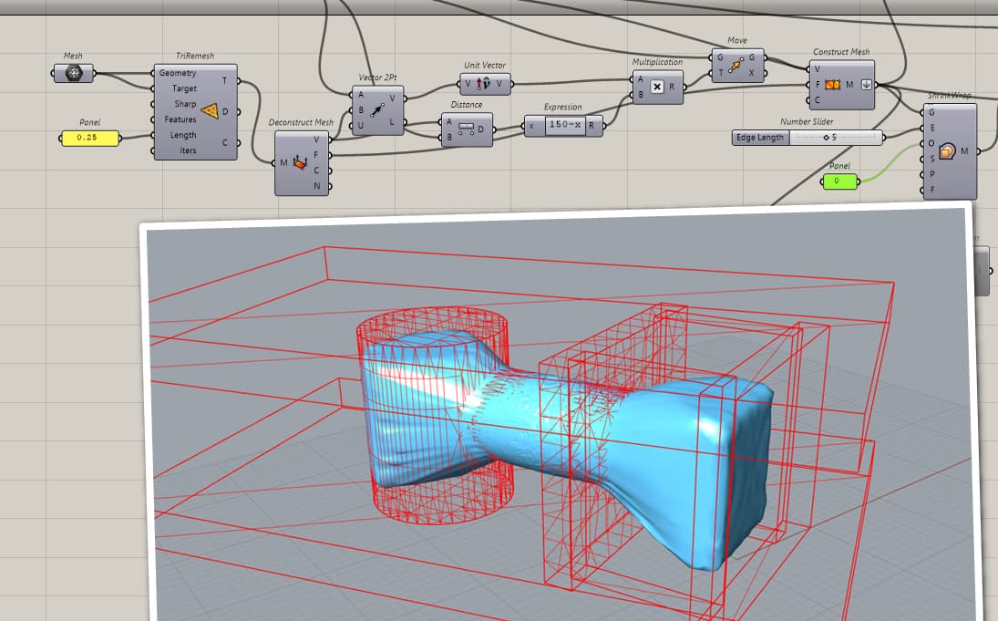

Hello
when you said inverse it means you could also invert your mesh so inside will be outside.
A mesh could be inverted from a point with a formula like that
DistanceInverted = 150 -distance
and then come back with
Distance = 150 -DistanceInverted
Depending on the point I choose on a line inside the volume
Convex hull on an end
reverse geometry.gh (49.5 KB)

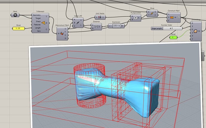

Defects are due to triangles that are too big when inverted. If the remesh is done with said 0.25 it is better.
Here’s another take on the invert-wrap-invert idea
invertwrap.gh (41.4 KB)

This output (the blue solid) seems to be exactly what I am looking for.
Does the gh-script need the specification of an interior point?
It should be, because there are many possible different outputs, as the initial solids (red solids) enclose many different volumes.
