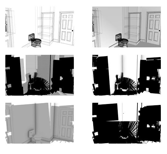

I’m having an issue printing a layout in Monochrome with Silhouettes turned on. They print as fat lines and not as per the appearance on screen. has anyone else had this issue and know how to resolve?

I’m having a similar issue, I think. When printing to PDF, the Monochrome Display Mode goes crazy.
It also happens with Technical, Pen & Artistic, but I don’t typically use those in Layouts.
I would recommend installing the latest 8.4 release candidate that was published today.
That worked, thanks! Looks like I’m getting some lines showing through mesh in places it shouldn’t. But I can work with this! Thank you!
