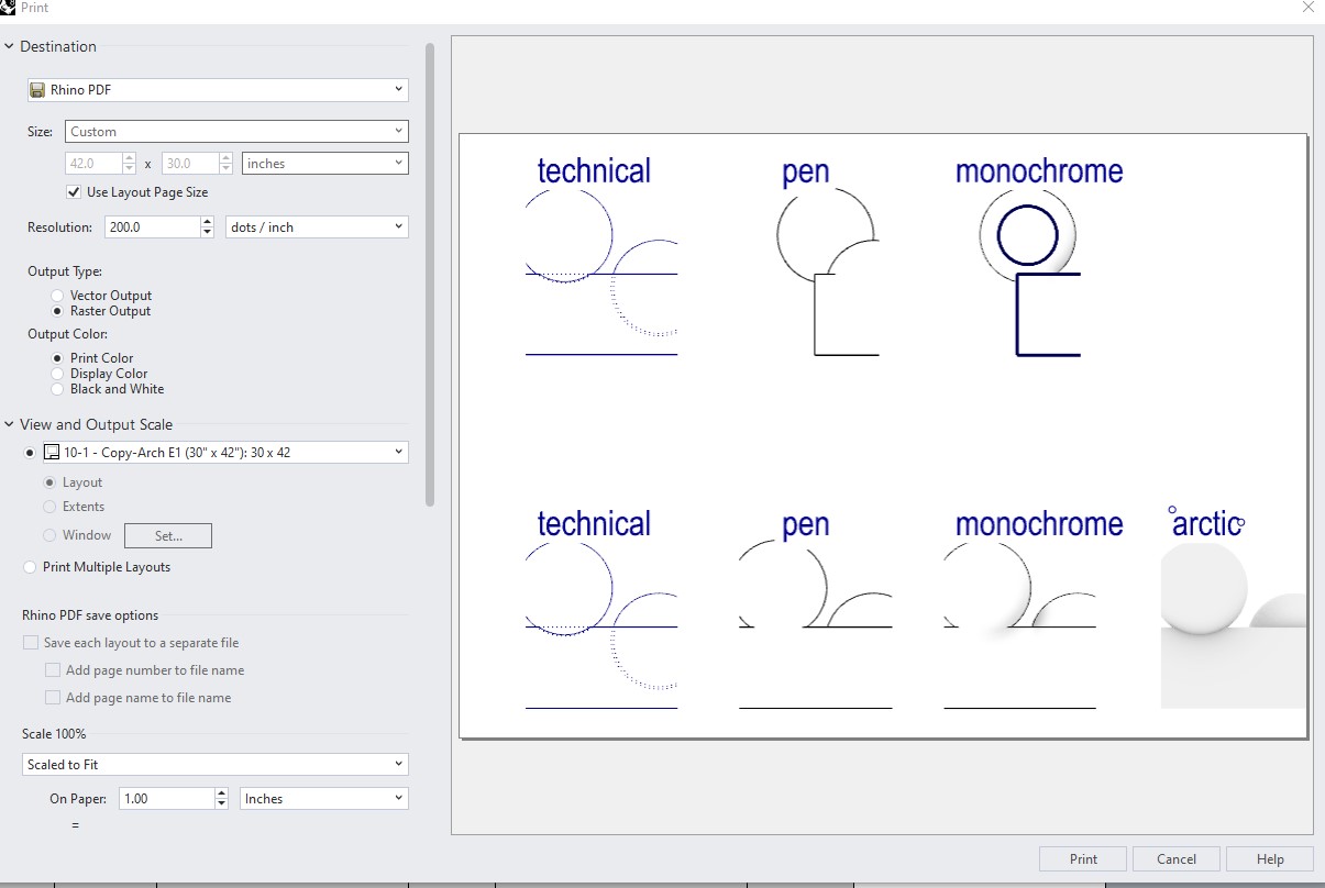

When I print a layout that has detail views in technical, monochrome and pen modes, the resulting pdf has thickened lines and looks different than what’s shown in the layout view and print preview. Any thoughts on what’s causing this? I never had this issue in Rhino 7.
Thanks in advance!
What version of Rhino are you running? PDF export in Rhino 8 is different from Rhino 7, and there have been some bug fixes in the 8.2 service release candidate. To get the service release candidate, see Rhino 8 Service Release Candidate Available - #6 by brian
Hi Brian,
Thanks for the link! I updated to 8.2 and tried the test again. Unfortunately, the results are the same.

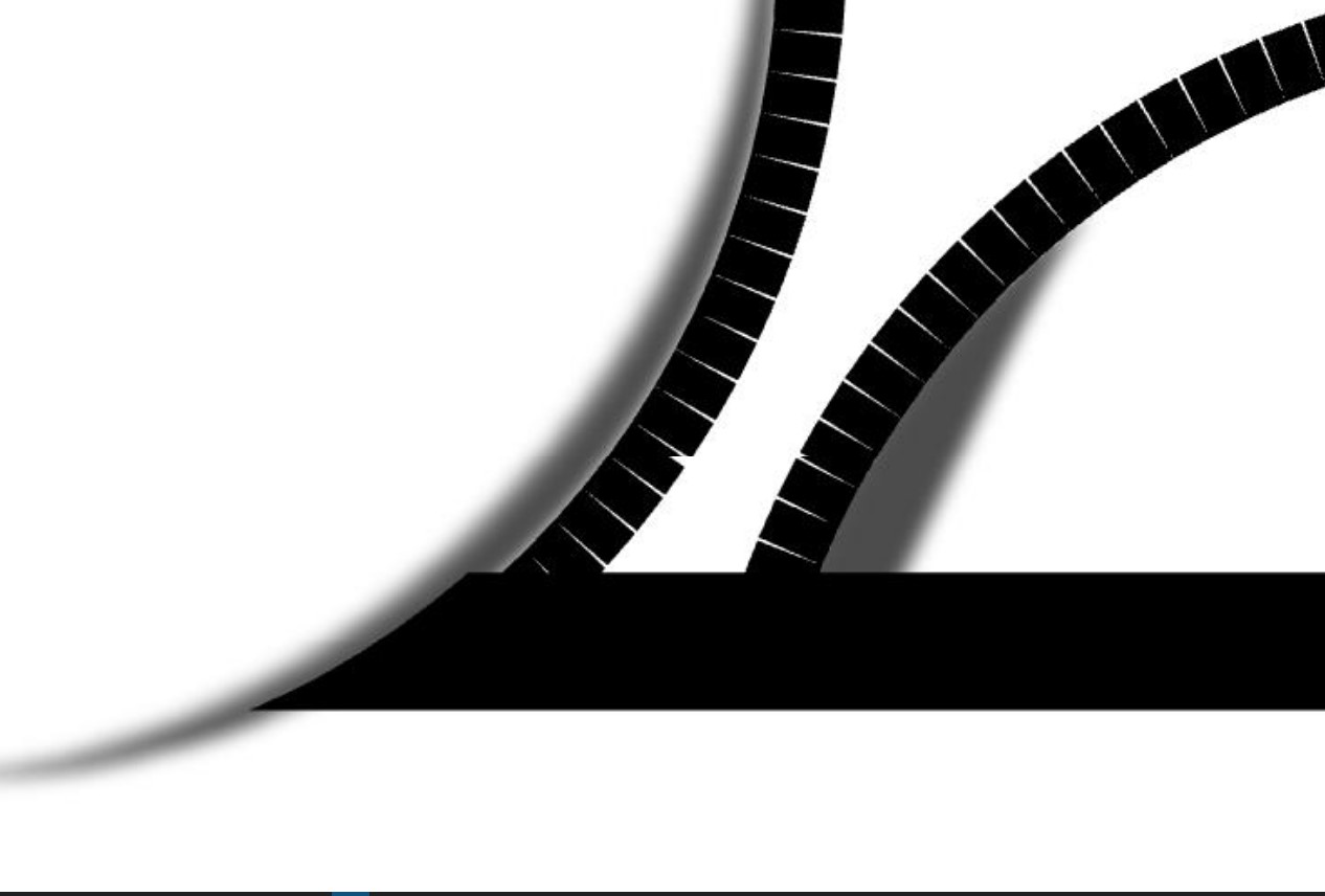

Layout view with print preview on:
The resulting pdf

I’ve logged RH-79212 Raster printing makes lines thicker and thicker

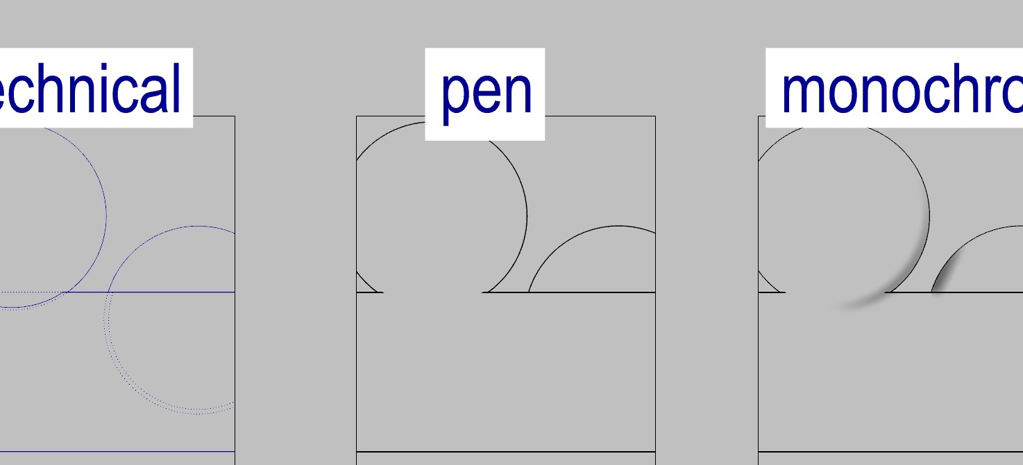

I am unfortunately also experiencing several artefacts with pdf-layout-printing.
I am using detail views with a certain locked scale in which technical view is selected in order to be able to show hidden lines.
When exporting with RH 8 the following artefacts appear; I do not get any hidden lines.
view in layout
view in printed pdf
When using RH 7 I get the following artefacts.
view in layout
view in printed pdf
Since I tried several options from changing view display styles, properties of layers/detailview-windows I think my only chance to get a pdf with hidden lines is to change my workflow to Make2D.
It would be very very helpful though to be able to use detailview-windows, select a scale and a display style and be sure to get whats beeing previewed in the model/layout view. Otherwise an intermediate step with make2d always needs to be remodeled, when changing the input model while working on revisions.

I’ll send you an 8.4 build in a DM; please reply here to let us know how it worked.
Thank you guys for the 8.4 build.
When exoporting using the same print settings (just changed hidden lines from 2.0 to 0.5 lenght)
the pdf now clearly shows hidden lines - only some small artefacts seem to be left; see interrupted hidden line on the picture.
thanks,
Georg
Hi Georg -
Yes, that seems to be an issues with the Technical display mode.
RH-79394 Display: Technical draws incomplete lines
Hi Georg -
I was wrong saying this was an issue with the display mode. The surface that is showing the dashed lines is a single surface with creases. Above that are “normal” surfaces that are split at the tangent creases. You need to run DivideAlongCreases on that one surface for it to behave as expected here; or turn OFF Show creases in the Technical display mode.
