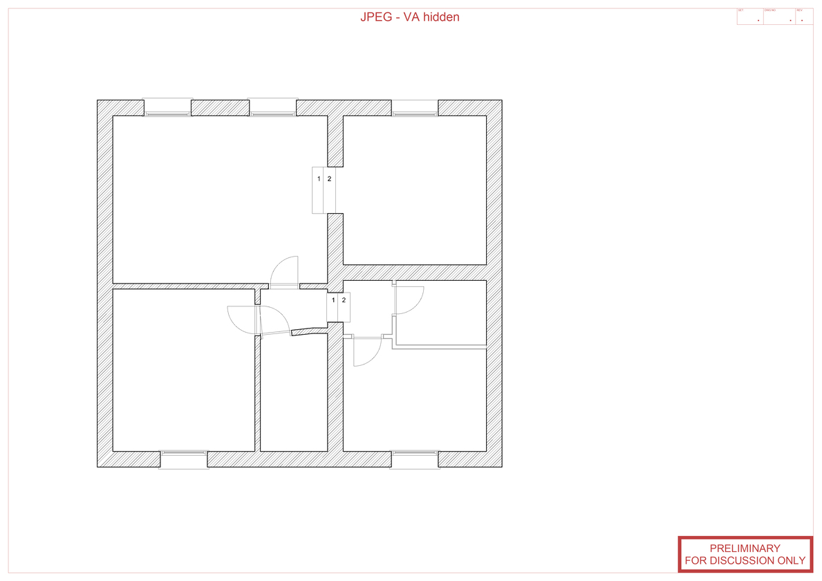

Im having trouble printing using the Rhino Pdf printer. When set to Vector, my linework/dimensions come out crisp but the raster image of the model is very low quality. I have tried chaning the resolution, but there is no improvement.
Is there another setting that I am missing?
Any suggestions on what the problem might be?
007C CHALLENGER EXT SET BUILD_20180430_RHINO PDF_VECTOR_600 dpi.pdf (1020.1 KB)
007C CHALLENGER EXT SET BUILD_20180430_RHINO PDF_VECTOR_2400DPI.pdf (1020.1 KB)
007C CHALLENGER EXT SET BUILD_20180430_RHINO PDF_VECTOR_1200DPI.pdf (1.3 MB)
If I print an image file set to JPG with 300dpi resolution I get a good quality image. This is the quality I’m looking for in the PDF setting.

I believe Steve Baer is the PDF wizard. I’ve sent him some examples of the low quality prints at 600DPI. I agree 300DPI is crisper. Hopefully between the two sets of our sample files they can get it figured out soon.
What I am really asking here is how to make the same quality pdf as the jpeg print above. The Rhino PDF quality is very low compared to when I export as a jpeg. Please look at how much crisper the jpeg is compared to the PDF. I have this problem in every Rhino file. Not just this particular. The Rhino PDF image quality is very low.

When I Zoom in on the three different PDFs, all I’m seeing different is the Adobe PDF is using a thinner line width.
What specifically is it about them that you see as “poor image quality”?
Are you looking at them on the screen?
Are you looking at prints on paper?
Are you using VisualArq for printing? I don’t see a layout in this model with the hatching
Hi John
Its the fuzzines/pixellation around the line work that worries me. I am looking at these on my screen as I don’t currently have access to a printer, but the ones I sent originally were printed and you could see the difference in the print quality.
Yes Steve, I am using VisualArq. but the problem persists when I do not use it too. The original images in this post were not created using VisualArq.
Have you tested the original images with SR8? I just want to make sure.

I’ve compared the 3 pdfs and the jpeg. The pdf at 1200 dpi comes closest to matching the crispness of the jpeg in the details of the jet raster.
Hi Enric
When I print using Rhino PDF in Vector mode this is what I get AT 600, 1200 and 2400 dpi:
32c milmay park 20180802_TEST_2400dpi.pdf (298.1 KB)
32c milmay park 20180802_TEST_600dpi.pdf (299.5 KB)
32c milmay park 20180802_TEST_1200dpi.pdf (853.2 KB)
Its not nearly as good quality as yours. I am not sure what I am doing wrong!
