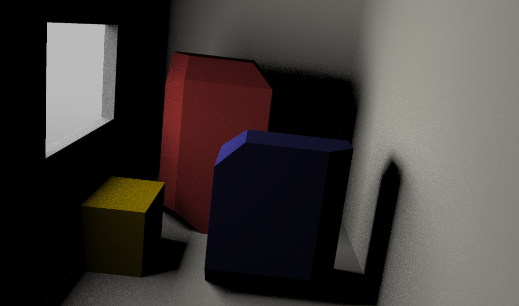

Yes, it works with a few boxes in a simple space. Took about 4 minutes for this:
GPU-Z shows high activity during the render on the NVidia. So does Taskmanager.
So it can work. And it looks good.
