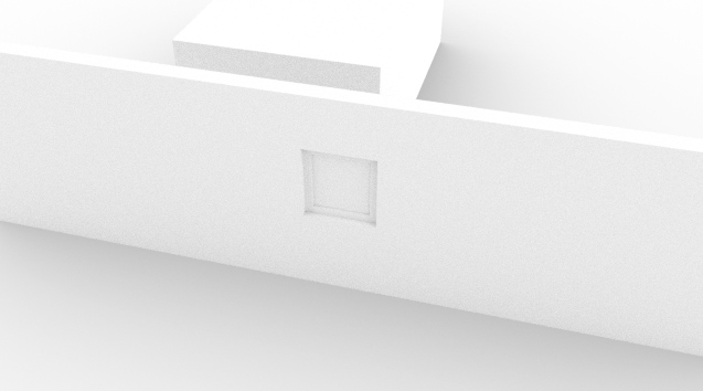

Light from Sun and Rectangular LIghts Dim in Rhino Render
The glass was assigned the glass material within the Va window style editor, receiving whatever material attribution Va uses by default. This should be brought to that team’s attention.
Even with a pixel size of 25, nothing happens. I will need to work on that sofa to further reduce its complexity.
With the sofa unfixed no dpiscale value will help, unless you pick CPU for rendering (:

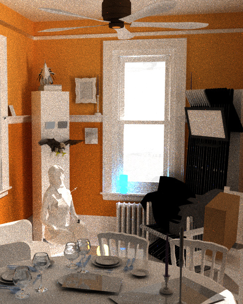

When the material is set to Clear Glass for the VaWindow Leaf’s Glass element, as are the WIne Glasses, this is how Render View Mode Interprets the scene:

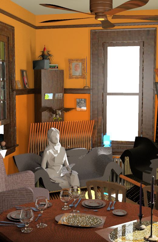

This is the best I have so far in Rhino Render with the same settings and scene (the oval dishes aren’t oval though. The transparent corners are reflective, but that’s not what you and I are dealing with for now.) The point here is that the windows are windows:

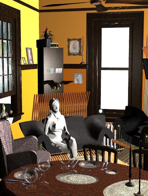

Here is how the windows are in Raytraced View Mode with the identical settings and scene. you should just barely be able to see that the glass is rendered in the same wood material as the window frames. It’s so dark because no light’s getting in but a fill light I set up inside. YOu can see that Raytraced is reresenting the material correctly on the Wineglasses though. It just can’t read the same glass material on the windows…:

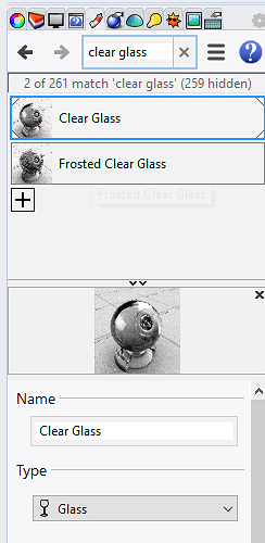

How strange, this is how it looks like when I use Clear Glass from your material list:
using this Clear Glass
I thought it was something like you show in the below post. So as long as it’s within Va, Raytraced probably can’t read the material definition so it goes with “By Layer” which is how the rest of the window is set up for material definition. But all the other render modes can read it correctly, but in the instance of Raytracing this is another case of incompatibility between Rhinio and VisualArq.
