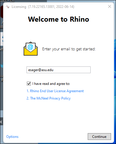

@fsalla I did the steps you recommended and the result was not as expected.
If I do not lock the license numbers to one (1) computer, it appears that I cannot use Rhino unless I uninstall Lands Design and VisualARQ.
tl;dr:Go through 1st iteration steps and you will get the picture.
Steps (1-5):
- Click to open Rhino.
- Enter email and agree to terms; click
Continue
2a. Looking for license
- License found. Selected

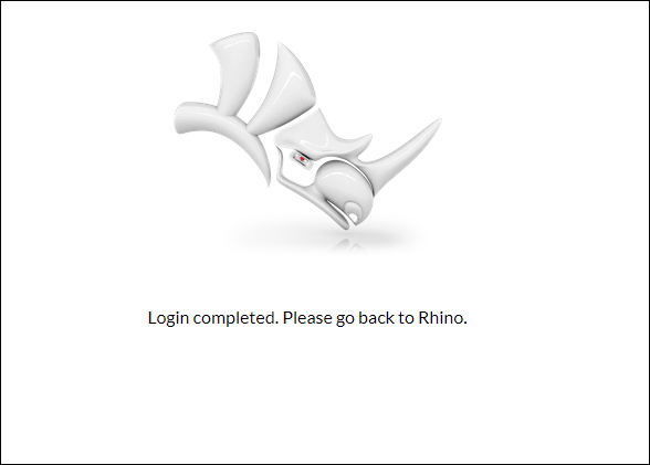

Login as [my email address]
- Browser opens and I login.
4a. Dialogue briefly visible: Enabling license
- Dialogue box opens:
Lands Design needs a License and another dialogue box (error) opens at about the same time: Attempted unsupported operation.
