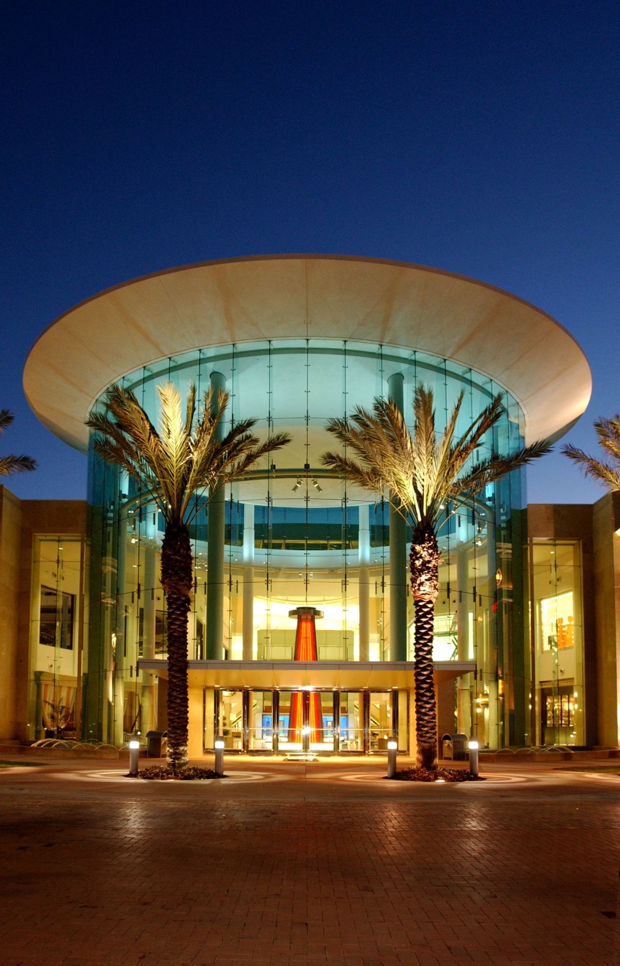

Excuse me, I didn’t read threw the whole thread, but I just want to throw in a few design Options.
I worked for the facade company which “planned/constructed” the facade of the “Steve Jobs Theater”.
The Roof is 48m Diameter Carbon fiber reinforced plastic. 44 supporting glasses with 3x7,3m each. No auxiliary constructions, just the glasses.
Or for example one of the many apple flagship stores with glass columns. Could be a solution to your design Intention.
As mentioned, I don’t know for what your Building is or how big, but this might could be some “almost realistic” Solutions.
