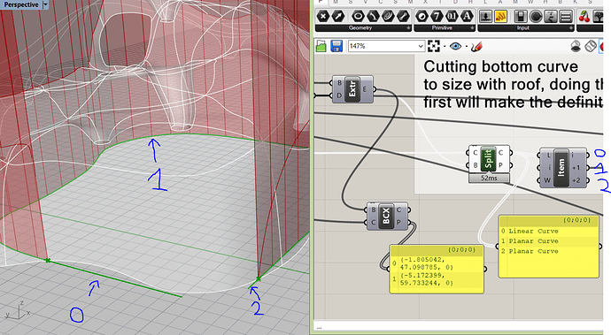

I found out what causes the problem with both ā€˜srf split’ and ā€˜split brep’:
ýour roof srf has a lost of ā€œinner edgesā€ and when one of those edges exactly matches the start or end point of your cutting lines two different things happen:
-ā€˜split Brep’ returns 3 instead of 2 results, this can be handled with some data sorting i did that in the new definition
-ā€˜srf split’ will return 2 ā€œwrongā€ results
i tested baking the components in rhino and doing it manually and it works just fine so maybe this is a bug @DavidRutten?

the part in the red dots is for getting rid of the parts of the bottom curve you dont want anyway so you don’t have to 1. calculate the lines, 2. calculate the extrusions, 3. calculate the cuts, 4. find no cuts, 5. sort out the extrusion which didn’t got cut. of course the result is the same, it just takes more computation time
the expression is for the cases where brep split gives the wierd results. in words it reads something like:
If the number of elements in a tree path is more then 2, cull out the item with index 2, if not cull out the item with index 1. Which for this dataset gives the results we want. the expression also sorts out the uncut pieces because when a tree path has only 1 item in it it will be sorted out.

Infact in that part you calculate an extrusion with wich you want to split the curve from list item But can you see in the picture below?
the extrusion does not intercept the curve. So you get in the output C of split with Brep the same input curve.
So why all those components??

ā€˜Brep | Curve’ does find the intersection Points which are needed to split away the curve ends, check the Point output. ā€˜BCX’ and ā€˜Split’ do different things so they shouldn’t be interchanged.
I use ā€˜Split with Brep’ in the definition and it does exactly what i described i don’t get where our misunderstanding is.
So it’s very strange, because i have different results! :thinking:
1)i have no points from BCX
2)i have only 1 curve from surface split
here the definition of the screenshot likethis_2_RE2.gh (1.3 MB)
isnt the same of your definition?
EDIT
I get your result if i plug-in the Boutput of cap holes in both BCX and split
Maybe you meant this way? and so however we dont need the part in violet group.
Anyway it’s just a curiosity, because i’m going on in the definition and we’ve already solved that problem :slight_smile:
i found it:
when i open your gh file with RH6 it works just like i described it.
when i open it with RH5 it breaks just like you described it.
there seems to be a change in how ā€˜Sort’ works. Change the list Item Index after ā€˜Sort’ from +1 to i like you see in the picture and it will work again.
