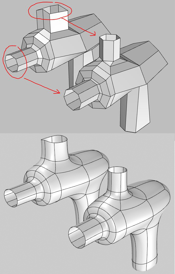

Haven’t used Rhino SubD yet, but with T-Splines, is essential for efficacy with anything complex, especially forms built from multiple elements to be joined into a singular mass. (Efficacy may include imported geometry too)
Essential because, with complex forms and/or extensive manipulation, topography can get sloppy yielding a mess. One learns to ā€˜read’ box mode to rectifying any counterproductive ā€˜slop’ as well as box topography consistent with aims. RAPID toggling is the means.

u can sorta do a simple hack for now (as long as there are no mix creases)
another little gem to have would be to convert any ring into perfect circle
Nice idea, I filed it as https://mcneel.myjetbrains.com/youtrack/issue/RH-55054 . You can do it now though with a selection filter to grab all the verts and then use Pull to a cylindrical srf. It’d be faster with a command though and I also asked for a radius value.
