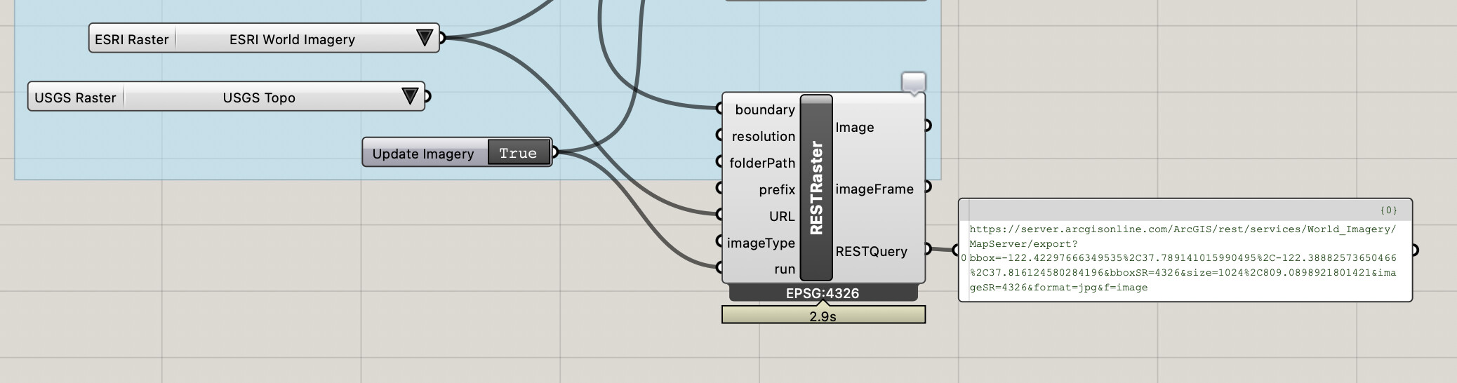

Good morning Brian!
I am having trouble getting Heron working on my Mac Mini m4
I’ve tried with both Rhino 7 and 8
On Grasshopper settings I have set Heron to run from disc
The component I’m trying to use is RestRaster
______
On Rhino 7 with Heron 0.3.8 installed via PackageManager
as soon as I connect the ESRI World Imagery to the URL input (and have the get input as True) I get an error:
  1. Solution exception:The remote server returned an error: (500)

Hi @Andrés_Martínez_C ,
Can you post the definition that is not working for you? The remote server 500 error can be because your boundary is too small (double check your units), or there is no data within the boundary (make sure you have the EarthAnchorPoint set).
-Brian
HeronMac_Example_v0-3-8_.gh (49.1 KB)
I’m using a file you uploaded in another thread.
I actually just tried Heron on a Windows computer it was working perfectly previously on version 0.3.9 and it is no longer working either (REST Raster component)
Did they arcgis change something in their backend?
I was able to get this to work in Rhino 8 (rosetta) with Heron 0.4.2.1 using the file you uploaded. Make sure the EarthAnchorPoint is set.

I’ve had a same issue, but the issue was simply the boundary curve was not a closed curve.
