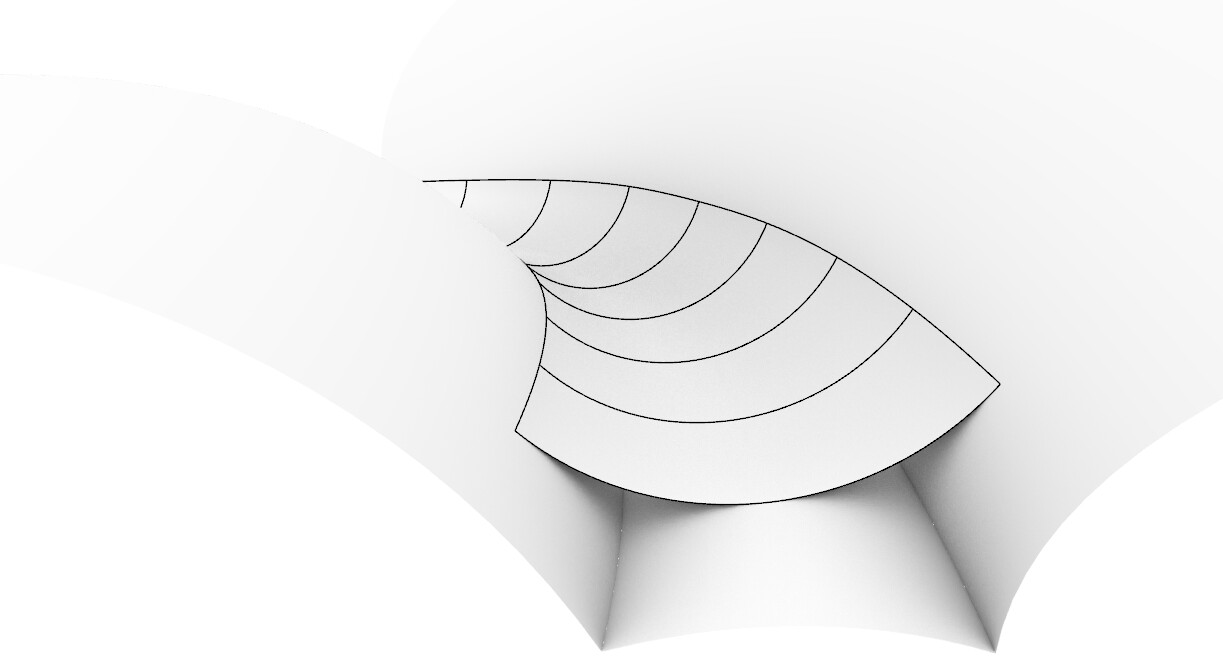

Hi all,
A command I miss sometimes from other CAD softwares and it may be very decisive for me, is the tritangent fillet which in rhino already exists for curves (circle tangent to 3 curves).
For example in the image above, the valour of the fillet radius along the path will not be constant, because the angle of the patches are not constant with respect to the base, so doing a fillet in one side and another one on the other side, will overlap each other…
Is that possible to achieve that in Rhino without any aproximation that is not an exact radius ?

That kind of command:
One challenge with arbitrary input non-planar surfaces is to what should be the orientation of the fillet sections.
Fillet3Srf01.3dm (3.4 MB)
I do not know how similar the method below is to Martin’s Grasshopper solution.
Method used to create it:
First step is to create a guide curve the circular cross sections will be normal to:
TweenSrf to create a surface midway between the two outer surfaces.
ExtendSrf the tween surface to ensure it intersects the middle surface.
Intersect the tween surface and the middle surface to create the guide curve.
Second step is to create arcs which will sections of the fillet:
Plane with Aroundcurve option to create a large plane which will intersect the input surfaces.
ArrayCrv the plane along the guide curve,
IntersectTwoSets the arrayed planes with the input surfaces.
Arc with Tangent option using the intersection curves as the input. One arc per section.
Third step create the edge curves of the fillet:
InterpCrvOnSrf on the side surfaces using the ends of the arcs as the interpolation points.
Fourth step create the fillet surface:
Sweep2 using the edge curves as the rails and arcs as the sections.
