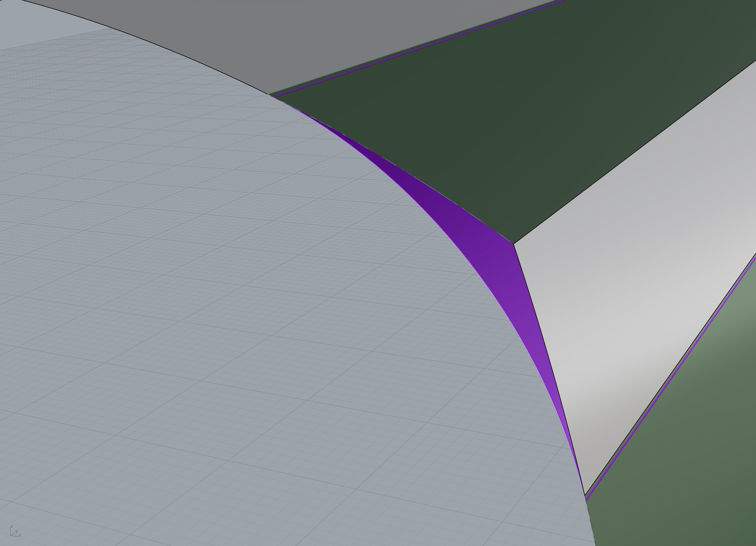

As I assume you know, it has problems when it run into a fillet surface with the same size radius. In your video it all works as long as your asked for radius went up to 1.9mm, but if you had pushed it to 2mm it would fail. When the fillet string encounters a same size radius it either fails or when it does make a surface the surface is not tangent to the base surface and also not tangent to the adjoining surfaces.
Another problem is when the base surfaces are not quite tangent. When the base surfaces are not precisely tangent it does not play nice with the extend and trim options. It will make the correct fillets, but turning on the extend option makes a mess. And trimming isn’t going to work without extending the end fillets.
Here is an example file. Try making fillets with radius of .125" :
[Fillet_breaks.3dm|attachment](upload://
Fillet_breaks.3dm (545.2 KB)
In the above file if you turn on the layer named “corrected” you will find .125" fillets with end gaps fixed which will make extending and trimming work.

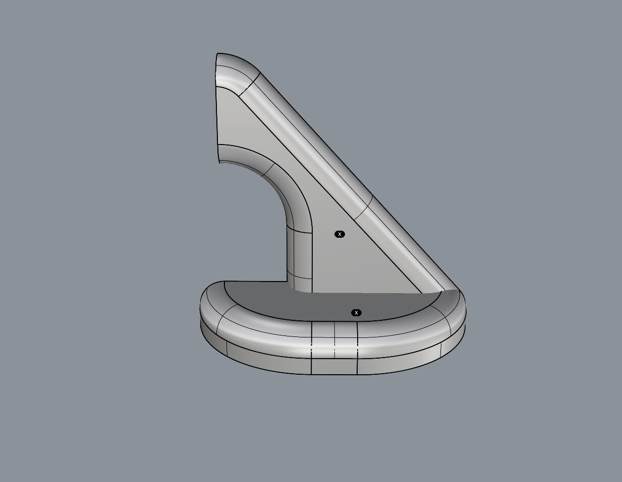

here is a (ugly) - but simple edge case, a simple extrusion, where the filletSrf fails because the in initial picked surface is no longer part of the (expected) result…
I know its a special case… but if it is not fixed now it will become a bug report after V9 is released

I would think this is not a bug, but you are actually asking to fillet the wrong surfaces…
you asked for the closer surfaces, but you really want the farther surfaces to be filleted…
would you not simply pick those surfaces as your starting inputs instead?
how is the tool supposed to know " I asked for this, but really wanted this instead" ?
not dismissing your comment at all, genuinely asking your thoughts…

_filletSrf R15 will crash Rhino
see full exercise here:
handle_2022_01B_filletSrf2025_rh9.3dm (993.3 KB)

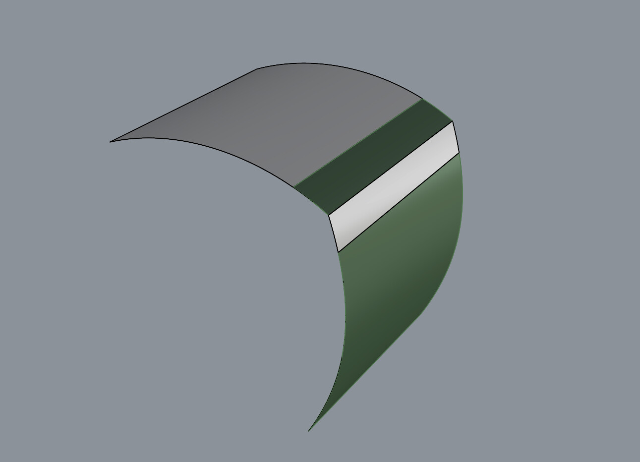

ok - and - to make it more a buggy special case - and many bug s are special cases:
filletSrf this example with R60
you will need to click the green surfaces.
filletSrf_r60_please.3dm (2.9 MB)
R60 applied
kind regards - tom
