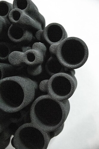

so I have been trying to mimic the shape of these corals
or these
I only managed to create the shape of the tubes, using curves and applying ‘divide curve’, ‘pframe’, adding later multiple circle using the ‘circle’ component and ‘sweep1’ for the circles connaction.
the qustion is - is it possible merge them into unified surface (and later apply offset),
so i could get a unified shape of the corals.

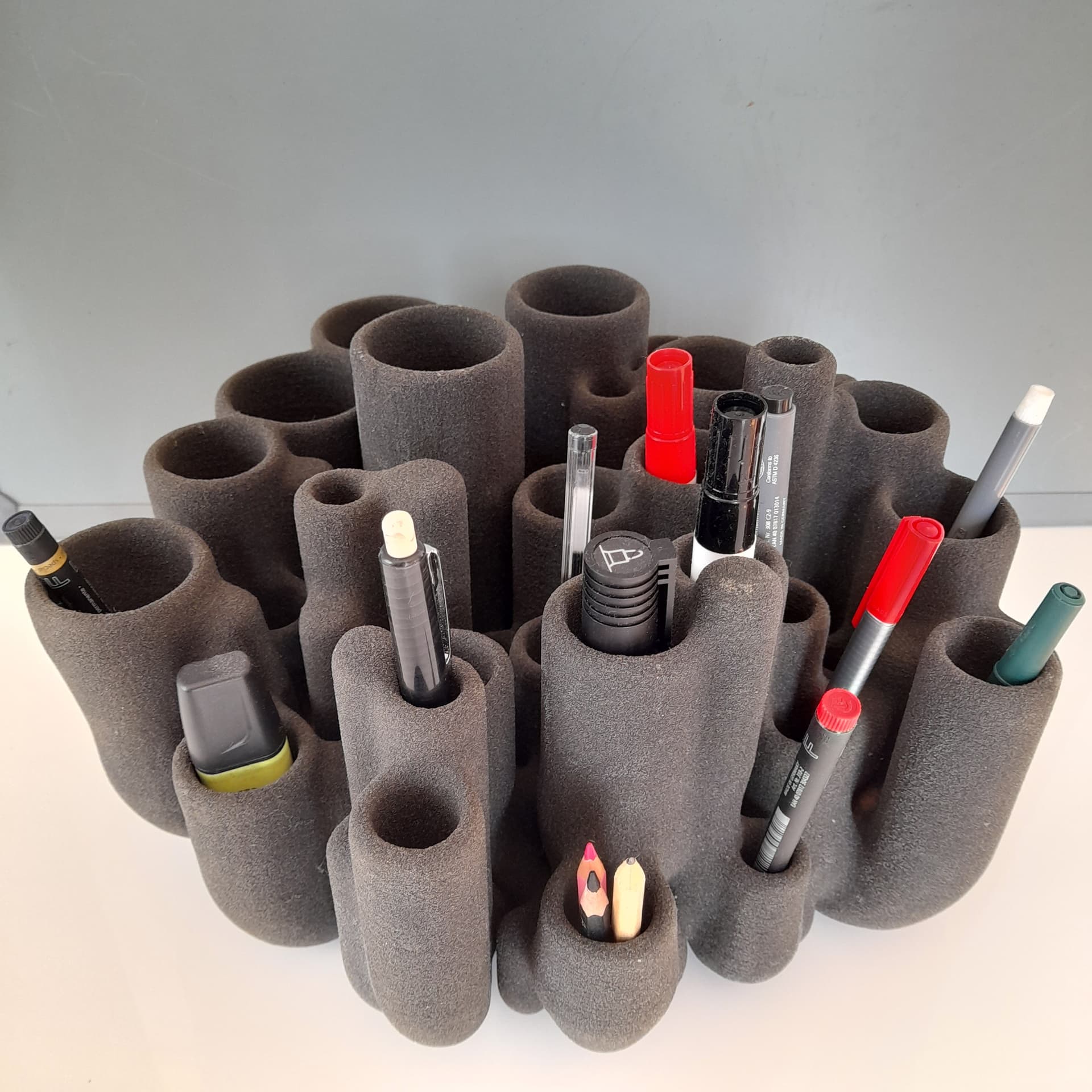

Hey! what about this design? Can someone help me find a solution or tutorial to achieve something like this? please :slight_smile:
Not far from this
