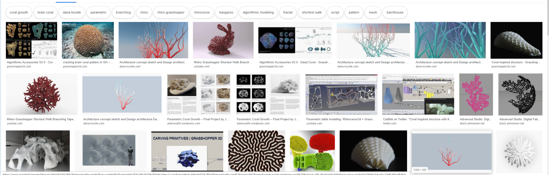

did you search on various forum with keywords like Coral, growth , tree … ?
You will need something to loop with as these are recursive systems (if you want them done correctly). Check out Anemone .
To mesh it you can use Dendro which is fast.

Yes, I did, but I don’t want to use the Shortest Walk plug in. I want to use another way…
Hello, there are many others way for sure. I will make it by doing my own growth algorithm, like the thing I did here.
