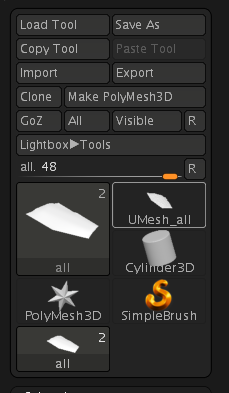

In the Subtool menu, at the bottom go to Boolean and click Make Boolean Mesh. If an error occurs, ignore it. In ZBrush, the boolean’ed geometry is put into a separate tool, usually called UMesh_your_name! You have to select it from the Tool menu:
57
It now replaces your current tool on the canvas! It’s probably a good idea to quick safe before doing this. Simply press 9 to quick safe.
