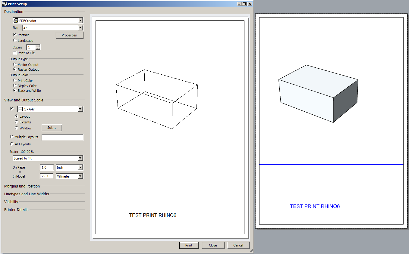

Wee have find a bogu for the printing object with rhino 6, it is impossible to print a object in rendered mod, all object appears in wireframe mode!!!:frowning:

Click on raster mode and check if that helps
Hi thanks for your response but
I have take a bad mod for explain this bogue
the bog appear with layaout mod,
do you have this bogue?

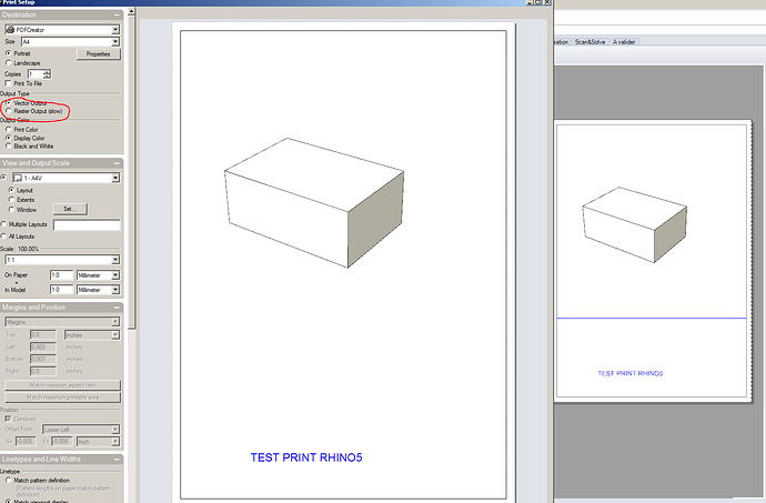

whith rhino 6, it is impossibl to print in raster or vector mod
but with rhino 5 all it’s possible.
I don’t know what that might be tbh
 mine works fine :frowning: (also layout view)

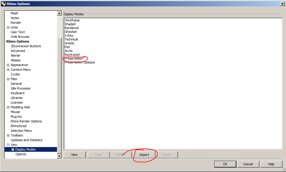

I advance a little with this problem, it seems to me that it comes from a custom presentation mod.
Presentation.ini
[https://smc2.box.com/s/g3abtyuh8onk9de9oljqzomyfamh92ol]( Presentation.ini https://smc2.box.com/s/g3abtyuh8onk9de9oljqzomyfamh92ol)
Can you testing the custom mode (Presentation.ini) to see if rhino 6 print corectly the geomety.
regards
Where do you place this file?
You might also want to check this topic
Hi
import this file in the display modes import and try to print test
