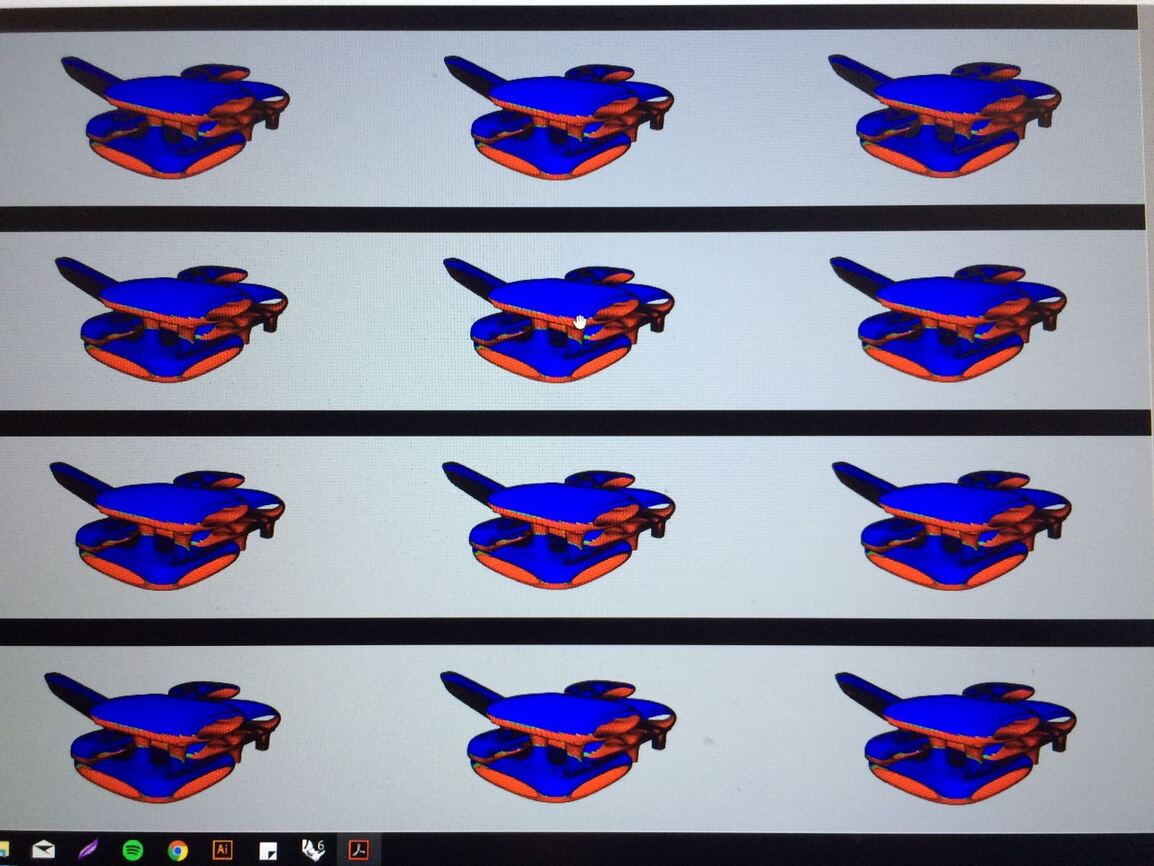

I’m using Rhino 6 and every time I try to get Raster Print the result coming out strange. It does not event take my window area however, there is no problem with vector output.
In the attachment, you can find the window area that I’m choosing, what raster comes out and the end result.

It looks like a raster print tiling issue. Does this happen with any file or with this specific file?
It happens with any file
Yes even if I change the devices it still has the same problem
