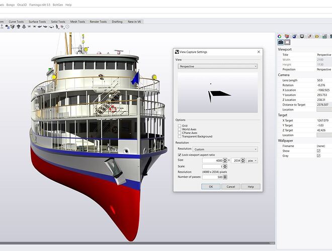

Well, it’s June 2020 and I’m having the same problem. View Capture to File shows the preview of the raytraced image ok and then grinds away for some time, but produces a weird result: an image file of a few black items. Any suggestions? Help!
Open your Notifications panel.
Does it suggest a display driver update or two?
If see, see if that helps.
Thanks John, but that didn’t work. See the attached screen capture.
Now, it’s just giving me an all-black image.
I updated my Nvidia GeForce driver to the latest one as well as all my office updates. Any other suggestions?

What happens if you use a more reasonable capture resolution like “Viewport”?
Same result. See the attached screen capture.
Funny thing is that it worked OK at the original high resolution a couple of times, but stopped working today.
I try an capture at resolutions high enough to print in a magazine. I can always de-rez, but you can’t up-rez.

Please run the SystemInfo command in Rhino and return the results.
Hopefully something will show up.
Here’s the system info:
Rhino 6 SR24 2020-3-19 (Rhino 6, 6.24.20079.23341, Git hash:master @ 064283610b834170e52117f2656605b5b25d65c0)
License type: Educational, build 2020-03-19
License details: Cloud Zoo. In use by: dave ()
Windows 10.0 SR0.0 or greater (Physical RAM: 32Gb)
Machine name: DESKTOP-6SDRTKB
Hybrid graphics system.
Primary display: Intel® UHD Graphics 630 (Intel) Memory: 1GB, Driver date: 1-22-2020 (M-D-Y).
Primary OpenGL: NVIDIA GeForce GTX 1060 (NVidia) Memory: 6GB, Driver date: 5-15-2020 (M-D-Y). OpenGL Ver: 4.6.0 NVIDIA 446.14

I suspect the problem is your old Intel display driver.
Please install this one from 5/29:
Better?

Well, I tried that but still no luck. The Intel driver has been updated, but see the result in the attached screen capture.
This isn’t the full black screen, but the weird black artifacts I was getting.
Would the Intel video driver be a factor here, in any case? I have my Nvidia GeForce 1060 set for Rhino and for my large screen display, which is what I use for Rhino.

Try disabling penguin, orca, and flamingo in the plugin manager. Restart Rhino and try viewcapture again. This will let us make sure that a plugin isn’t somehow involved in the issue.
Steve, John:
I disabled Bongo, Bolt Gen, Rhino, Penguin, Flamingo and Orca. Still got the same result on View Capture to File. See the attached screen capture.
I uploaded the file to your server a few minutes ago.

Dave -
This model is going to need a few layers of fixing to try and get it to fit on the video card memory.
First of all, run Analyze Pulldown > Diagnotics > Select Bad Objects. There are 26 in the file. These need to be fixed. Here are details on fixing bad obejcts: https://wiki.mcneel.com/rhino/badobjects .
The render mesh contains 17,311,107 mesh faces. We like to see less the 10 million, even less if possible.
  1. 7 million of these faces are in the two dingies and 4 jetskis.
  2. 3.1 million faces on the hardware layer
  3. 1.5 million faces in the chairs and tables on the back deck
  4. 1.1 million in the lifeboat pods.
  5. 730,000 in anchor gear and anchors.
I would look at each one of these parts of the models and determine how much these models could be reduced and still fulfill their role in the rendering.
I run a large Nvidia RTX 4000 video card with 8 GB of memory. The larger video card allows for a larger model. Here is the rendered mode in Rhino 7:
And the Rendered viewport in 7:
