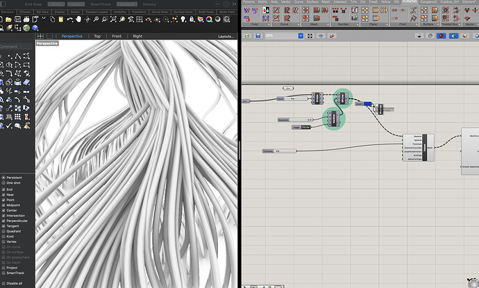

I am trying to mesh a high number of curves generated through MAS strategies Using Cocoon. The thing is, it is incredibly slow to compute and I was wondering if you have any tip to optimize the computing time ?? I tried rebuilding the curves and decreasing the control points (I have no idea if that changes something to Cocoon).
One operation takes up to 1h30 min, meaning to tune and change parameters I need to wait again and again, slowing the exploring process.
This is a screen shot of my curves, roughly 625 curves.
I am on the latest Rhino WIP for Mac, running it on OS Mojave, a 512 Go SSD, 32 Go Ram, i9 2.9Ghz Cpu.
Any tips or remarks are welcome.
Hi, there I believe is an issue with cocoon, its a pretty slow marching cubes implementation, I believe there are other faster options.
I really recommend you to use instead of marching cubes, a voxels system it might not be perfect but it works and is lot faster. something like monolith.

Dendro will also do the job quite fast. It uses the OpenVDB library from Dreamworks.

@Antonio_Cersosimo you could try daniels skeleton fattener Skeleton fattener + mesh cage morph
it only works with polylines from what i have understood but maybe worth a try.

You can use it with curves by turning them into polylines, but I wouldn’t recommend using the skeleton fattener on millions of segments, and it won’t solve lots of overlapping parts like you have here.
Perhaps what you might try instead (and this could speed up either the skeleton fattener or something like Dendro) would be to first consolidate the curves into a much smaller number by combining nearby points.

I tried the Skeleton Fattener, and works perfectly on Mac and in an extremely and surprising fast way …
However, my initial input curves don’t touch each other… so I get meshes that are interdependent without any meshing between them. Is there any way to make it one general mesh ? I m trying to achieve something like the examples published upper in this page. Again thanks for your time…

Not sure if chromodoris works on Mac, but it is a very fast matching cubes implementation. It’s multi threaded and uses a kdtree, so it scales very well.https://www.food4rhino.com/app/chromodoris
It was developed for this project which is a very dense mesh… https://www.kokkugia.com/RMIT-Mace
