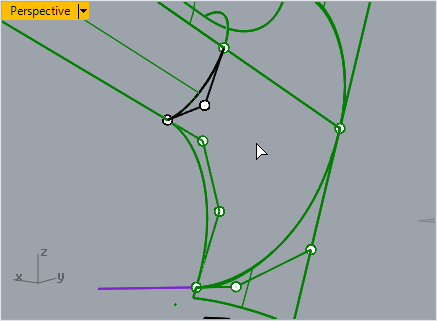

OK, here we go… in pictures. The first image shows why I made my original comment about rebuilding, the rest a sort of blow by blow… shout if you have questions.
Note all curve matching and surface matching is for tangency only in this set of steps.
AND, you might get a perfectly good and quicker result, once the shape has a nicer trim like in my first couple of images, from BlendSrf, and not jump through all the hoops.

For some reason the trim at the bottom of the cylindrical surface is messy - not a clean arc
ShrinkTrimmedSrf then untrim that surface to get a clean edge curve. BTW, ideally, I would not even use the arc directly - DupEdge, and then rebuild the resulting curve to degree 5 and 6 points. The true arc has weighted control points, and EdgeSrf will propagate that into the resulting surface - not the end of the world but the surface may be better behaved if it is ‘non-rational’, i.e. control point weights all 1. I did not do that in my example above but it is not a bad idea. A six point degree five curve gives a very nice approximation of a 90 degree arc.
Shrink, Untrim, DupEdge
Rebuild:
Surface:
Make sure when you MatchSrf at the bottom/trimmed edge, use “Preserve isocurve direction” Match for Tangency and “Preserve other end” at tangency as well, and “Match by closest points” for this bottom edge as well.
