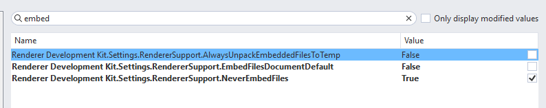

Is here something new about it, in Rhino 8 - choice “off” support files?
I used SaveSmall not to save textures in Rhino files. My texture files are all organized, and I only want to link those.
It has been working well, but now I’m getting this image every time I SaveSmall (that’s my Ctrl S).
I can’t even permanently make it No since it’s greyed out once I check “do not show.”
I tried to SaveAs without texture, but next time I SaveSmall, I get the same message. Quite annoying. How would I force Rhino to ignore textures and just keep it linked?
@l11 I hate this too as a user, though from a support persons’ perspective we are typically happy to have textures saved in the file. We’re not planning to change this, but you can change the behavior globally in Advanced Settings
Renderer Development Kit.Settings.RendererSupport.NeverEmbedFiles
I hope that helps
Thank you. Hope this does it
