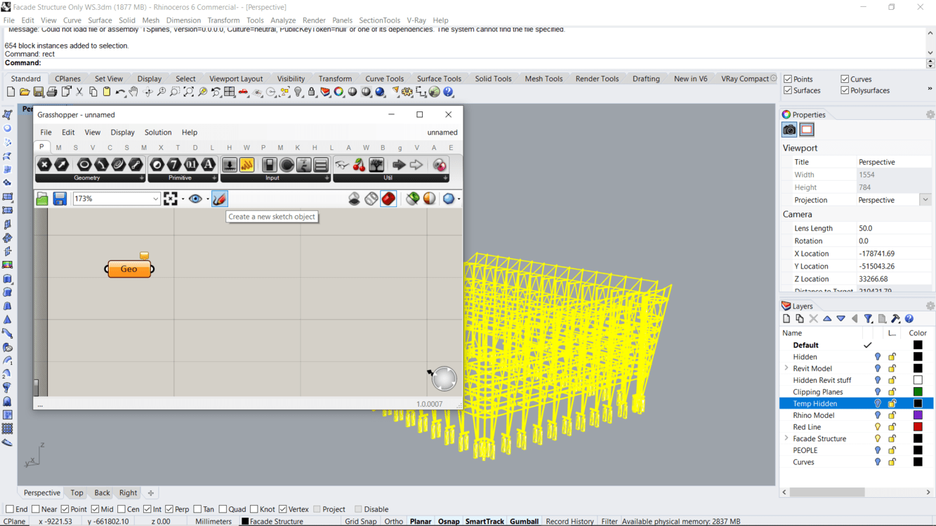

Anytime I attach any of the files,
Facade file + Structure file = Memory runs out
Facade file + Interiors and Walls = Memory runs out
Structure file + Interiors and Walls = Memory runs out
Interior Walls + Facade File + Roof File = Works perfectly
However, any combination with the structure file and Rhino runs out of memory and Crashes.
Specifically, the structure file to the Facade file, in a work session. Rhino runs out of memory.
Or as an externally referenced block, it runs out of memory.

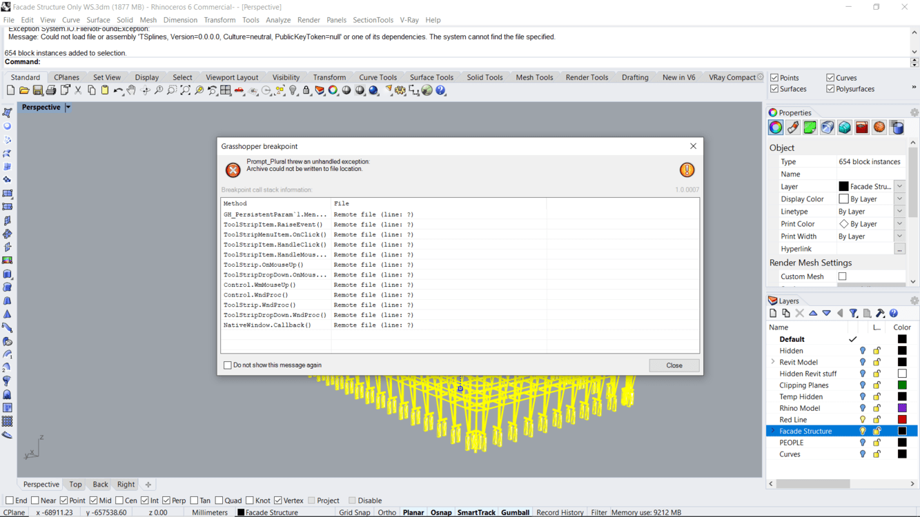

I tried, referencing the geometry in grasshopper, so I could at least get a reduced version of the file. So I could open it in any of the other files. But It also runs out of memory.then the screen goes black for a sec then Rhino exits.

When I try to ClearAllMeshes, Rhino runs out of Memory.

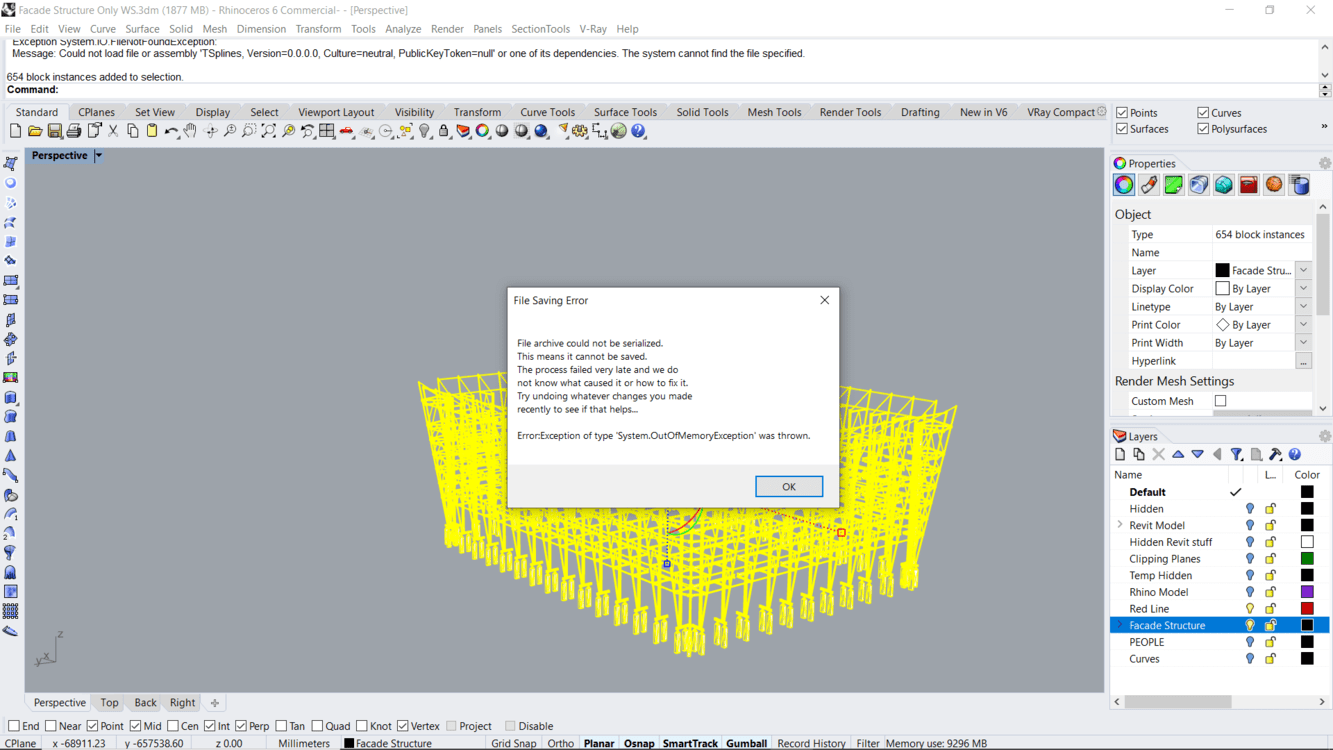

Hello - yeah, I can imagine it may be slow - lets try one more thing - SaveAs the large file to a new name and in the save dialog, check ‘SaveSmall’. Then attach that file to a wireframe-only file… does it work at all without the meshes?
I’m still trying to Saveas, for the Past 20 mins.
Its still saving.

AutoSave, then open the resulting autosaved file and rename it - make sure that none of the views are shaded. Attach that file. My theory of the moment is that Rhino is running Windows out of memory in the process of creating render meshes - I could be completely wrong, but my suggestions are an attempt to see if that is correct.
(Autosave may be a lot faster than a save.)
@pascal
When I tried this(saving small and attaching all files in wireframe mode), Rhino, run out of Memory.
