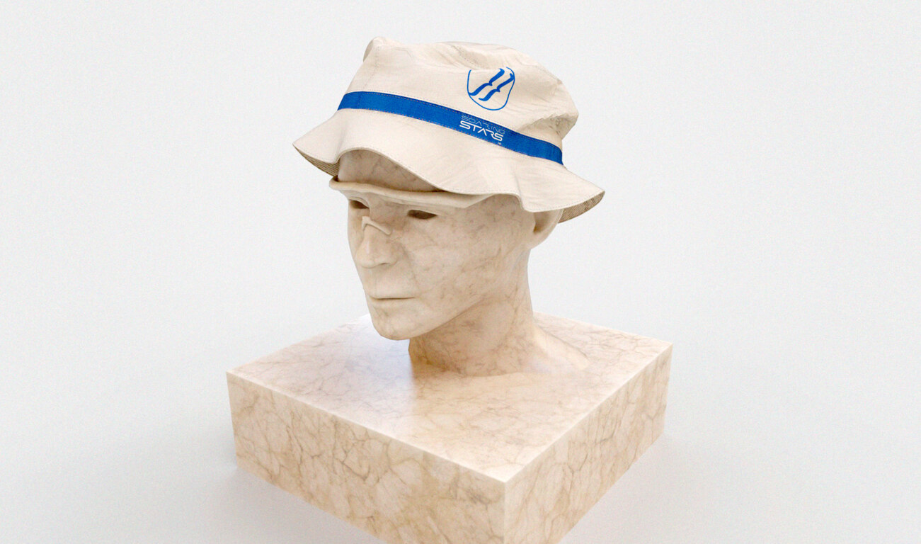

In this live stream, I will try to paint in real time a soaring hat.

WORKFLOW 2020
  • I use Rhino as a container.
  • The tubes or head made inside Rhino Grasshopper. [polysurface]
  • I convert to poly in Rhino [mesh]
  • Export it to Marvelous Designer to apply the fabric [OBJ]
  • and return back to Rhino.
  • Make the VU mapping in using RizomUV [OBJ]
  • return back to Rhino
  • I optimize the FBX inside InstaLOD [FBX or OBJ]
  • return back to Rhino [FBX]
  • Export to Substance Painter
  • I paint there and make textures for Rhino and Unity [.sbd?]
  • I press a button to render in NVIDIA Iray inside Substance Painter [clipboard]
  • I make a screenshot and open that in Photoshop and then the forum [jpg]
  • Return back with textures to Rhino.[jpg or png]
I render using NVIDIA Iray that it’s inside Adobe Subtance Painter. But I can only render one object at time. Is not like Rhino.
Yes As Jacoba mention I use Marvelous or Clo3d to put the fabric on top. But it is very difficult because the fabric pass trough colliders. Also fabric turns in squares when the edge is small. Need a lot of CPU GPU power. That is why I cut the fuselage in two. The wings covering are made in using Rhino SubD.
So very cool! I’ve thought about directly modeling wing fabric scalloping before by simply keeping the vert count low and pushing them in, but always felt a fuselage explicitly modeled in NURBS would be a tough magic trick to pull off.
Yes, if it is in metal or wood cover, then NURBS are ok. But tubes and fabric… that is hard. I try to learn from nature, not to fake it. Takes more time to fake it. I make the same process as reality. I use Grasshopper for the tube frame. GPU will grow at the same time as my skills. I’m using GTX 1080Ti i5 9600K but a i7 2600K was also ok.
