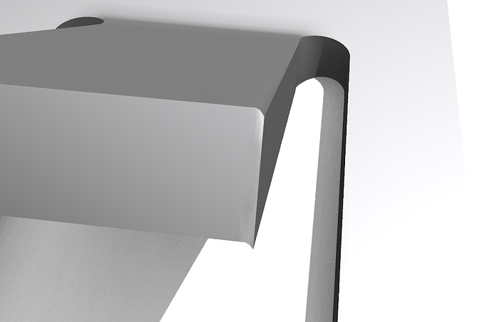

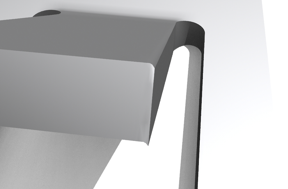

Wie kann ich diese Teil erstellen? [How can I achieve this form?]
Ich habe das mit “Flow” (einer Kurve entlang gleiten) versucht. Ich denke, das wäre auch die richtige Methode.
Aber es werden leider die Kanten verzerrt.
Wie kann ich das besser machen?

Hello, shall this be a real sheet metal part, that get´s manufactured under a hydraulic press brake?
Soll das ein echtes Stanzbiegeteil aus Metall darstellen, welches unter einer Senkbiegepresse hergestellt wird?
Of course, I construct such and similar existing articles for illustration . So I have to adhere to the guidelines.
The angled “tongues” should have a larger radius, as in the first picture. Unfortunately, I do not know how to do that.

At a first glance, the problem is the location of your fillet (the radius of the bending)
As you can see in the picture the upper radius which is ideally what the bending machine will do, is smaller but as it is located now it starts too much inside the material. You’ll have to move it “to the left”.
Depending on what your bending machine can handle you should leave 1-2 mm straight part and then the radius. Then also the inner part will not be that distorted.
Zunge_ipv.3dm (132.2 KB)
Note: I simply moved your curves to the left so the “tongue” part is a bit longer in the attached file. You should cut it.
